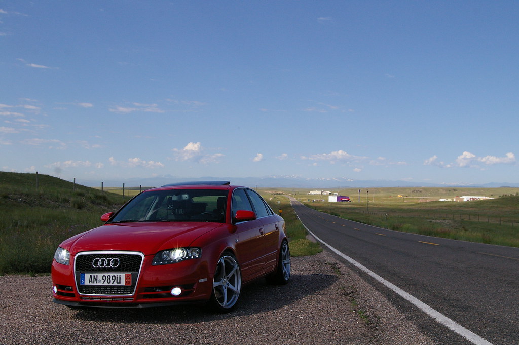

    Moving into more exterior modifications. Vorgtland Springs/shocks, USP rep wheels, FLY's V3's,
    IMGP2906 by DMK, on Flickr
    1013410 by DMK, on Flickr
    imgp2970v by DMK, on Flickr
    imgp2965i by DMK, on Flickr
    imgp2987 by DMK, on Flickr
    imgp2992 by DMK, on Flickr
    imgp2994 by DMK, on Flickr
