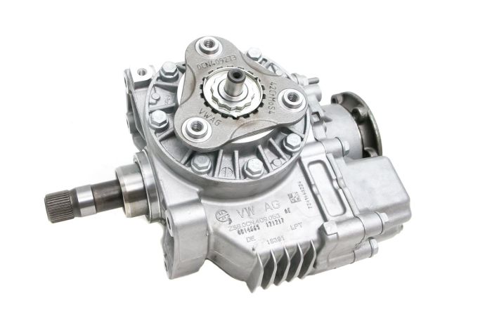

    0CN-409-053-AN Transfer case. The name "bevel box" comes from the name of the type of transfer case it is.
    The problem with the transfer case(AKA bevel box) is it holds 1 quart of 75w-90 synthetic oil and is air cooled! It has tiny fins on the bottom...and sits direclty behind the engine block. It vents to atmosphere.
    Most people dont even know it exists on their cars...
    The rear diff, minus the Haldex, holds 1 quart of 75w-90 synthetic gear oil. It too is air cooled and vented to inside the subframe then to atmosphere.
