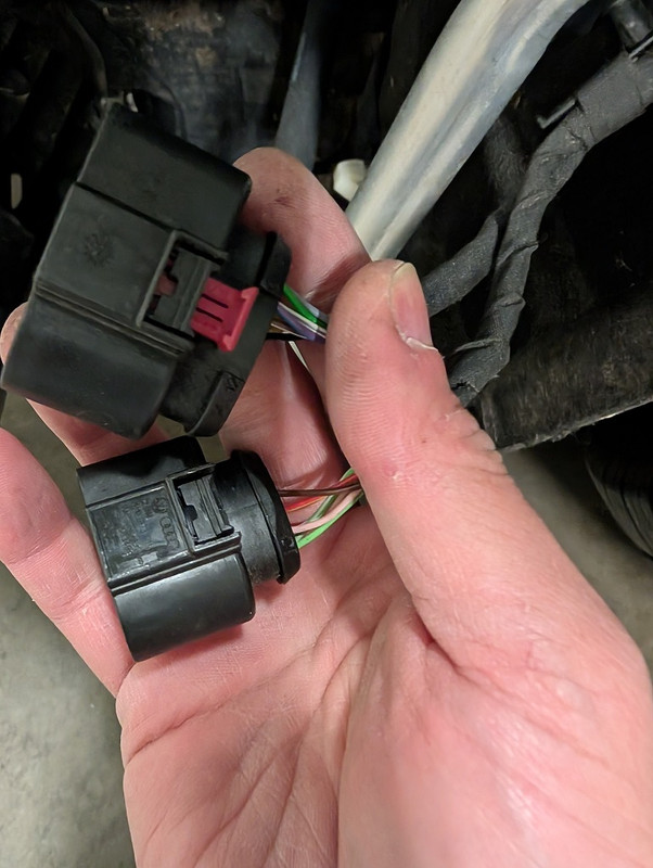

    Step 5:
    Remove 6x T20 screws at the bottom of the bumper
    Step 6:
    Pull the bumper side out of the fenders.
    Driver side will have 2 wire harness to unplug
    Passenger side will have 1 wire harness to unplug

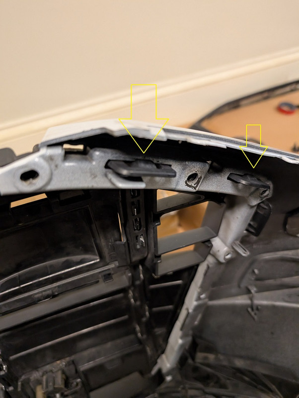

    Step 3:
    Remove grille from the bumper
    Push notch down
