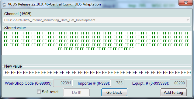

    Do you have VagCom/VCDS by chance? I was able to get this sensor installed but am unable to find the interior monitoring parameters specific to C8 A6/S6s. I've looked all through the internet and cannot find anyone that has posted it before. If you have have VagCom/VCDS and are able to pull this I would be forever grateful. Below is from a new thread I started. Please let me know when you get a chance. Thanks!
    If you have the OEM interior monitor/inclination sensor in your vehicle and VagCom/VCDS can you please help a brother out? I'm retrofitting the aforementioned sensor and I need this data to enable this device. This should be the same data set for all C8 A6/S6's and should be a combination of numbers and letters, not just FF FF FF FF FF etc.
    These are both found in Central Convenience (46) > Adaptations > ENG122925-DWA_Interior_Monitoring_Data_Set_Development & IDE05823 - DWA Interior Monitoring Parameter Set as outlined below.
    ANY HELP GREATLY APPRECIATED! I have the sensor installed and coded but am otherwise stuck without these parameters and am very envious of you all with interior monitoring from the factor. I have also searched all over the internet and couldn't find this info anywhere. Thanks in advance!
