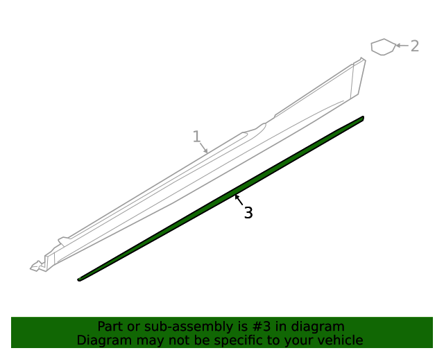

    I have been looking for the rocker strips in carbon fiber. I have seen them for the S4 but not for the S5s.
    I have seen a lot of bolt on side skirts, but not a direct replacement for the OEM rocker strip.
    Searches are leaving me a bit frustrated, wondering if anyone knows of a company that makes them.
    OEM part numbers are 8W6-854-868 / 8W6-854-867

    I own a coupe and yes my B9 has that rocker.
    Which is also pictured in the OP with the parts diagram and the OEM part number.

    Ok ? I have a coupe also and the trim is not stick on. I just got the two parts above from my local dealership.
    https://www.autohausaz.com/pn/VW-8W6854867

    Your local dealer is correct. The rocker for B9 S5 coupes is made of 2 part numbers. 1 part number for the painted rocker panel itself and 1 part number for the rocker fin that is the black textured plastic part.
    If you look at the link you posted, these parts are depicted as Part #1 and Part #3. What I am looking for is Part #3 in carbon, to replace the OEM black textured one. Similar to how the rear diffuser unclips from the rear bumper and the carbon one clips into place.
    If you were to unbolt the entire rocker (part #1) and remove it from the car, on the inside, there are clips that release the black textured rocker fin (part #3). ::Pictured Below::

    Yup, we agree. I just wanted you to know it was not a double sided tape stick on part like other models.
    I did not want you to waste your money and be stuck with the wrong part.
