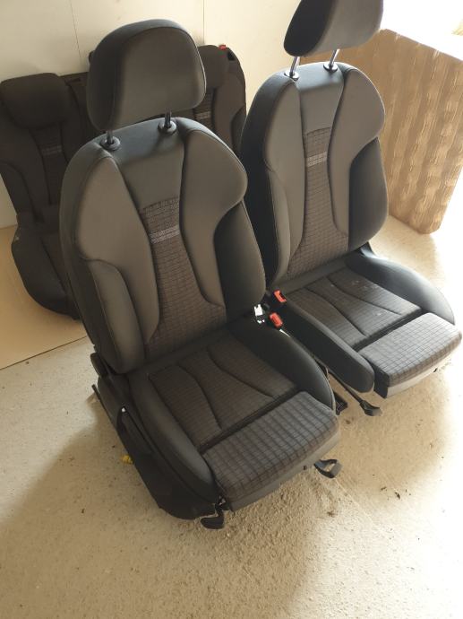

    We have the seats from this picture:
    My question is, can this be fixed with any other OEM seats? Every centimeter counts.. ( that's what she said )

    Here in the USA we don't have cloth seat. Only Leather in the A3/S3.
    I have found my friends A3 has more seat room...the A3 seats go back farther and sit lower than my S3 seats!
    I highly doubt any OE seat will give you more than you already have....
    Even in my A4...my drivers seat was all the way back and down.
    I am 6ft tall. 6.6 feet in the car....not good.

    Maybe an aftermarket seat? Recaro? Or a shop in your area could fabricate or modify the seat brackets to give you more room?

    Yeah, perhaps extending the seat railing would be a solution. The height I can live with, but I would definitely need the seat a couple centimeters further back.

    My Recaro Sportster CS seats lowered my RS3 seating by at least a half inch. Doesn’t sound like a lot but it’s noticeable. And the RS3 seats are manual every thing so they went lower than power seats anyways.

    I am 6ft tall. The seat in my S3 is all the way back and all the way down. Physically...the drivers seat can only go back 3" more inches and it will hit the rear seat. Unless you remove the lower rear seat cushion and you could get about 4". A 6 foot 6 inch person would need approx. 6"....

    A3 has a really high seating position and low headroom.. Pretty much have to put something like Recaro buckets on manual mounts to get that kind of headroom. When i get in it after not driving if for a while, it feels like it sits up like a truck.

    I went with aftermarket seats and the Planted seat brackets which lowered the seat height at least an inch. I'm not that tall but made a huge difference for me and can wear a helmet in the car with no issues now. Some drawbacks to aftermarket seats and a bit more work on installation but worth it for me.

    I wouldn't really need that much, I bet an inch or two would really make the ride more comfortable. I got used to the seat height, but having those few extra inches further back to just stretch my knees a tiny bit would be helpful.
    I still haven't found a solution, but did get used to it a little bit. The shop I contacted said they don't do this modification. I don't drive it that much anyways, so it's no rush. But if I eventually do figure something out, I will update this topic.
