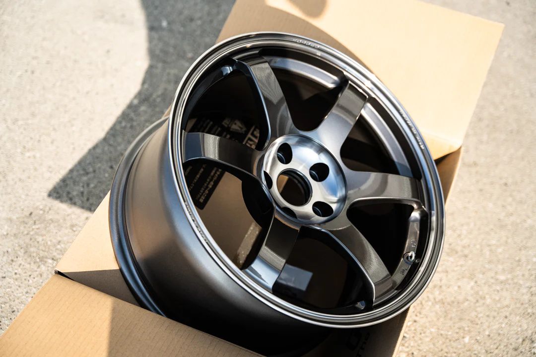

    Quote Originally Posted by Paul@SupremePower View Post
    💥TE37 SAGA SL 18x9.5 +22 front 9.5 +45 rear for RS3 8Y steel brakes💥
    Oh man this is a good one!
    Perfect front and rear offsets with square widths and even concavity: FACE 4 !
    This is the only TE37 I’ve found with this much concavity that clears the brakes and is also not too aggressive for the car needing camber or suspension mods. Bolt on and go!
    Clears RS3 8Y steel brakes. Unfortunately they are 114.3 but no big deal as we can drill em for ya.
    Fitment is confirmed and hoping to know stock status next week.
    18x9.5 +22 front FACE 4
    18x9.5 +45 rear FACE 4
    Pressed Graphite finish
    Can anyone confirm this setup works for 100% stock suspension without rubbing?
  22. #262
    Jan 24 2013
    108228
    Quote Originally Posted by stummiller View Post
    It’s really difficult to get rub at stock height on any spec.. You really have to do way improper rim and/or tire sizing for that to happen. That said, this spec will not rub stock height or lowered up to an inch with 265/35. Even lower on 255s.
    I’d love to see this setup done so Lmk if interested!

    Those te37s are sick. What is the process to redrill and how is the strength after? Is that the only color in this spec?
  24. #264
    Jan 24 2013
    108228
    Quote Originally Posted by FSTSNAL View Post
    It’s a slight shave 1-2mm of the bolt bores to bring the PCD to 112 from 114.3. Strength is not effected. You’d never even know it was done if not looking for it. See below of a different rays I drilled. Before and after.
