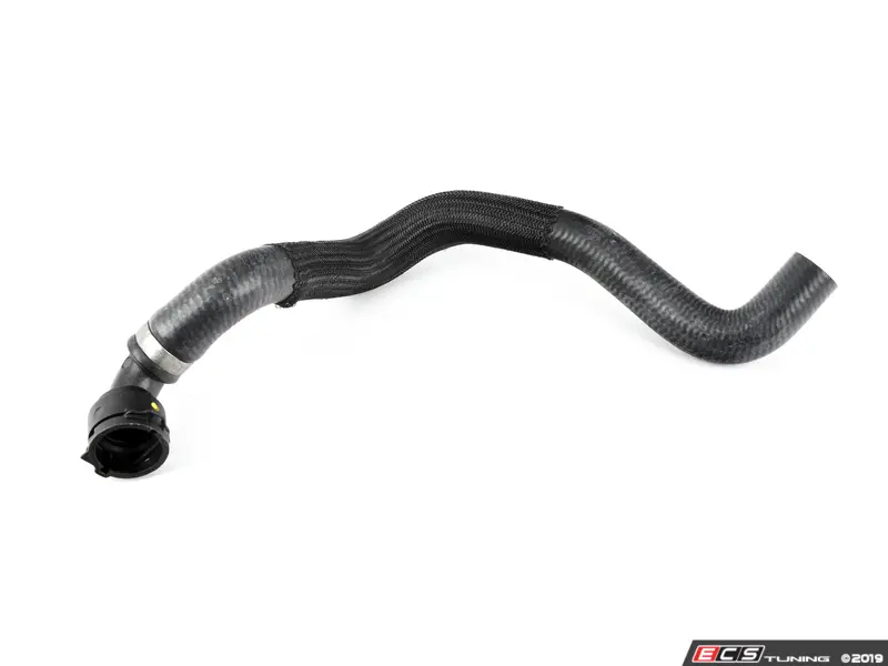

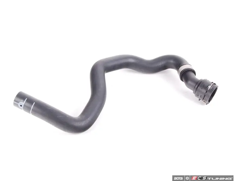

    OK - thought it might have been the one of the one's numbered as "17" which also show under the "Related Parts" - one of those looks the hose between rear flange and heater core that my mechanic had to be replace on mine. They are both preshaped but different part numbers - guessing the "T" might mean the one that attaches to the top of the coolant flange, and "R" means the one that attaches to the rear of the flange.

    I believe its the bottom hose in the above post: Rein Coolant Supply Hose

    Not sure what you would need to ask the dealer for. All 2.0 FSI A4s are going to have both those hoses. One goes to the heater core, one comes out of it. The dealer will just give you the part # for each of those hoses - which is listed on the ECS link anyway.
    As Gowking said, they are cheap enough to buy both.

    Thanks everyone so much for your help! It was indeed the bottom hose to the heater core. Took my chances and only ordered that one, turned out to be the right one! We got it swapped out and she’s back on the road.
