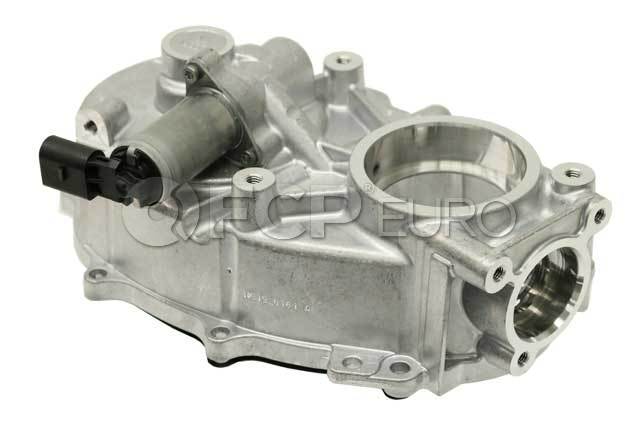

    Is this the cover part # 06D103153C?
    https://www.fcpeuro.com/products/aud...ver-06d103153c
    Aug 18 2020
    559892
    Sonoma, CA
    Nope, it’s this. $$$.
    06F103107G
    https://www.fcpeuro.com/public/asset...2i.?1541097468
