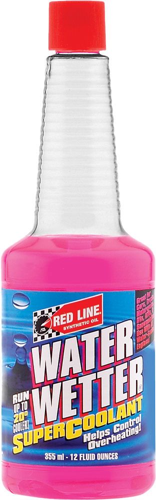

    For additional heat interchange efficiency, you can use some of this the water.
