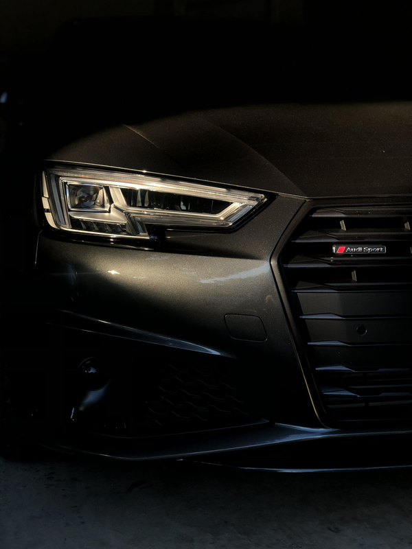

    The actual Quattro badge is held on by double-sided adhesive into a plastic clip on the grille. The plastic clip is a lot more painful to remove and you will probably break it in the process.
    If you want to remove the Quattro badge and put on something else, you can using any debadge method on the Internet - some heat, adhesive remover, and a fishing line to slice through the tape and the badge will come off.
    My car for reference:

    It came off very easily, probably easier than debadging any of the other badges on the actual car since it's on plastic instead of metal. You won't melt anything, just go easy on the alcohol or Goo Gone if you're using that to remove the leftover adhesive. It doesn't have to be perfectly clean because the new badge will be an exact fit over the badge holder.
