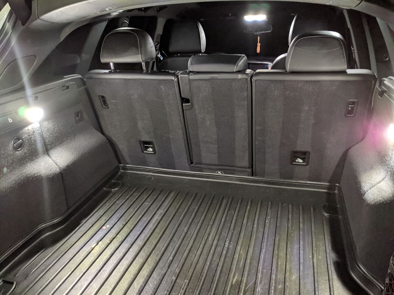

    Updating the interior and reverse lights with deAuto LEDs
