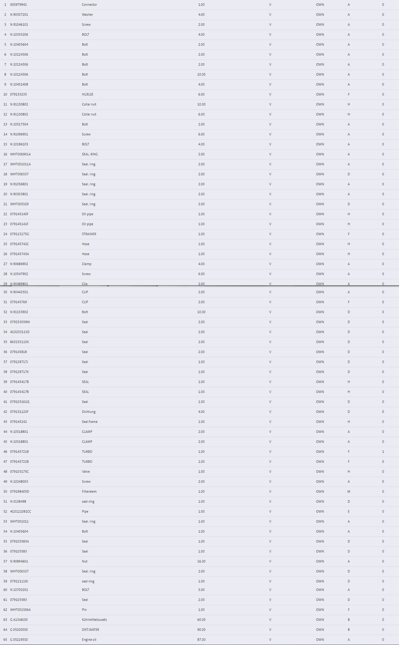

    Got the list of parts that were changed with the turbos, it has 65 points, oil screen is the latest revision: G
    I will leave it here, maybe it's good for someone who wants to do it by himself. This change was done at the local Audi dealer under warranty:
