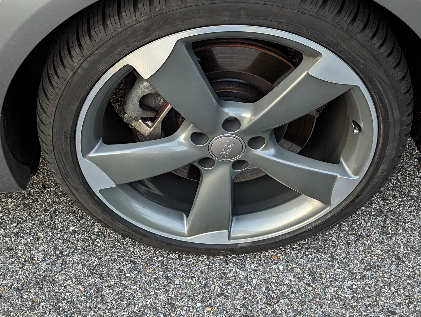

    A bit before the pothole, I purchased a set of S8 calipers (F&R) from a member on here and was told they would all be direct bolt-on, including the rears. (Narrator: They weren’t)
    I sat on the brakes for a while, about June last year, I found Brake Performance finally offered S6 front discs. Sign me up! I had Brake Performance on my B7 for a time, so I trusted them. So I bought a F&R set with ceramic pads. Also got stainless lines from USP Motorsports. My rears were shot so I was excited to upgrade to the 356 mm rears!
    Finally time to install…
    Nope! The S8 rear calipers do not fit. (The parking brake motor connector and brake line need to face the same direction; here they were opposite. Also, the S8 rear knuckle must be different, as they would not accommodate a 356mm disc anyway).
    I had to scramble and got a set of OE sized coated discs from Advance Auto. Installed them with the original calipers and brake perf pads.
    Fitted stainless lines all around.
    S8 fronts were a direct fit, and easily installed. I did reuse the clips from the old pads (razor bladed them off and stuck on new). Bleeding was significantly easier than 18Zs!
    Quite beefy under those 20” wheels!

    Update! New shoes!
    Purchased a set of Vredestein Hypertracs in 255/35ZR20. Was debating between Michelin Pilot Sport All Season 4s and Conti Extreme Contact DWS 06+s. The Vredesteins is they have a 100 day trial period and 8 year warranty vs 60 days and 6 years for the others.
    My Michelin A/S 3+s were down to 3/32nds and were getting squirrely on Maryland roads. Our roads a crap anyway, as evidenced by exceptional performance in the wet on a drive back from WV with downhills/curves between 70 and 90 mph.
    That said, this process has been a headache. Purchased 8/12 from Tire Rack. Shipped to Mr. Tire and arrived on 8/16. Worked night shifts, so should have been installed on 8/21. Mount, balance, and alignment did not happen. Waited 2 hours and in the process, they broke their plastic duckhead (required for low profile tires) and had no replacements. 1 tire installed. To get me out of the way, they remounted my other wheels using the metal duckhead and damaged wheels.
    I was fuming. They did accept responsibility and did not charge me for the one wheel, but the attitude of “you can go pound sand” and "go to a performance shop" when I collected my tires really turned me off. I limped the car over to RAI Motorsport. They got me setup to get the wheels repaired (and looking phenomenal) and the new tires installed. Now I just need to get Mr. Tire to reimburse me for the cost of getting this done…
    RAI did note that one of my wheels has a slight bend in it, so that one is on the list to get fixed too...
    Initial impressions after ~100 miles. Note I haven't had a chance to drive in rain yet.
    • Great warranty! Vredestein provides a 100 day trial period to see if you like the tires. This is fantastic since I am not sold on them yet.
    • Quiet! This is to be expected with new tires vs highly worn tires, but still refreshing.
    • Smooth! Feels much smoother on the road. Similarly to be expected but also a different compound. I feel this compound may have less silica in it but I’m not sure.
    • Dry grip is fantastic! I’m able to take some really sharp curves at high speeds without any break in traction. At least as good as the Michelins here.
    • Appearance: They look great and have a wheel protection built in.
    The not-so-good:
    • Lower mpgs. So far, I’ve noticed I’ve gotten several mpg less than I would have expected based on some short drives I’ve done. Longer-term tbd.
    I'll keep things updated but hoping as I drive mpg improves.

    Now that’s out of the way. In December, I did the 75k service to the car at ~73k. Interestingly I pulled ~7 liters of oil out, despite the capacity being 6.4 L. I suspect it’s diesel dilution. Car ran smoother, obviously. Using Liqui Moly 4200.
    I did not change the fuel filter immediately, but let me say when I did, holy heck did the car instantly change. Much smoother behavior, what feels like more power, and better mileage. Change your fuel filters, folks!!
    On my way to hitting actual 75k miles, I was getting vibes like I did when my engine mounts needed replacement last time. Have a nice vibration both while driving and at idle, and the last time this happened, one mount had gone. I was told to check my trans mount, which was easy enough to replace, but it did not need it. I think next check will be driveshaft and rear diff mounts.
    Old (left) vs New (right)
    I finally bit the bullet and bought S6 rear caliper carriers. Bought them on eBay from Latvia, and they were both brand new and the price for both was what I’d pay for one in the US. And while I was at it, I decided to change my brake pads from the lackluster ones from Brake Performance to EBC Redstuff. Got the rattle clips from RockAuto for a fraction of the price (Uro). With new wear sensors and fluid flush, I am much happier now! I will need S6 dust shields at some point.
    Lastly, I helped move my brother (whose stuff is slowly filtering out of my garage), and while following him in the moving truck, the car was reporting a ridiculous 53.3 mpg (!!) from leaving his place to my house to unload the truck.
    Next in the car’s future are new tires. Current ones are down to <4/32, and are getting a bit squirrely. Thinking I might get some Vredesteins.
    Wow... I strayed for a bit and missed a lot of posts... Did I ever shared with the pics of the S6 calipers installed on mine?
