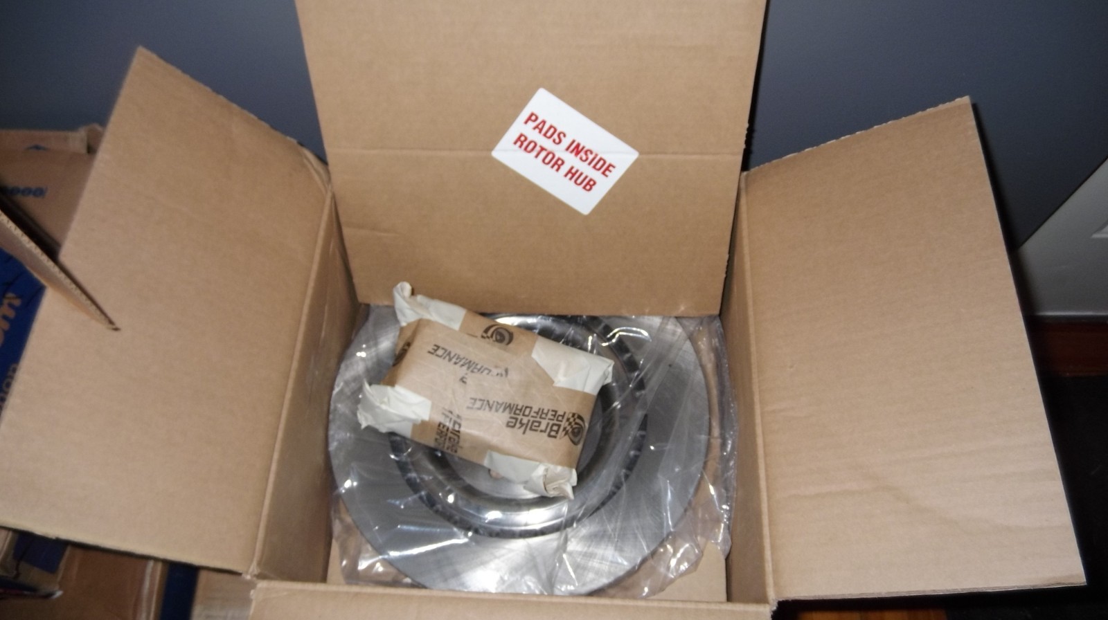

    I sat on the brakes for a while, about June last year, I found Brake Performance finally offered S6 front discs. Sign me up! I had Brake Performance on my B7 for a time, so I trusted them. So I bought a F&R set with ceramic pads. Also got stainless lines from USP Motorsports. My rears were shot so I was excited to upgrade to the 356 mm rears!
    Finally time to install…
    Nope! The S8 rear calipers do not fit. (The parking brake motor connector and brake line need to face the same direction; here they were opposite. Also, the S8 rear knuckle must be different, as they would not accommodate a 356mm disc anyway).
    I had to scramble and got a set of OE sized coated discs from Advance Auto. Installed them with the original calipers and brake perf pads.
