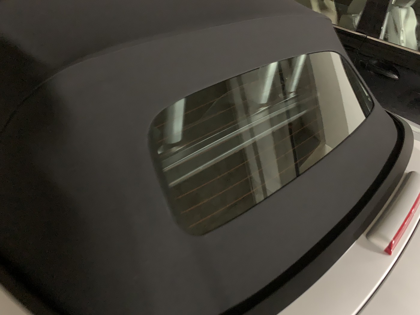

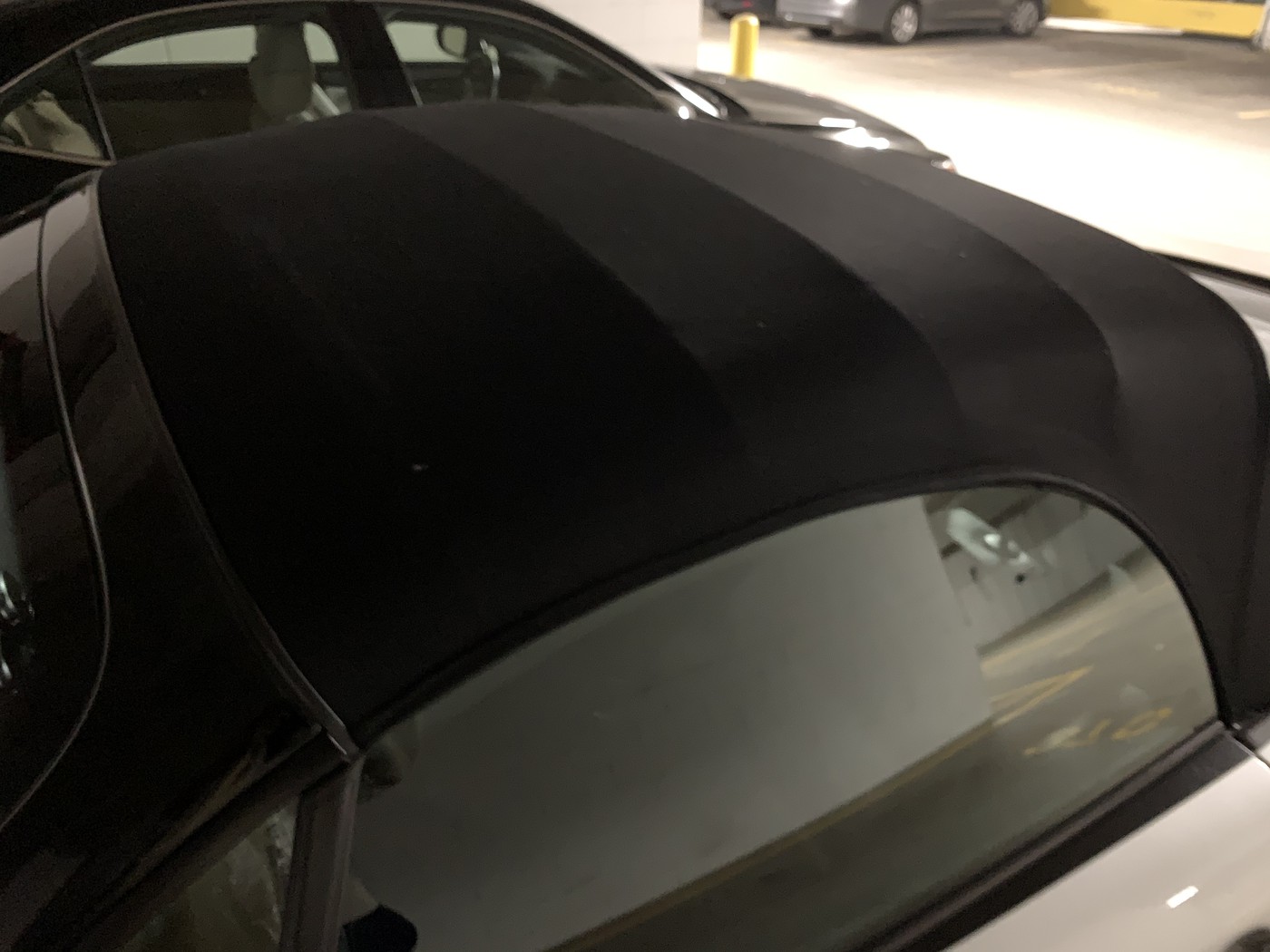

    New top, and micro switches for the said top.
    I've had the glass repaired twice, it separates and leaks eventually. The CCM sits in the rear where water can infiltrate the module and cause all kinds of anguish and hell.
    This is a fairly expensive repair but it's worth it to me.

    Nice job. I didnt get a vert just for that reason but i m sure its well worth it. My cheap ass would have diy"it and probably look like ass.

    The top has been installed and it's excellent, great fit & finish. Top, Microswitches, and labor 2300.00 No more leaking rear window causing damaging the CCM.
