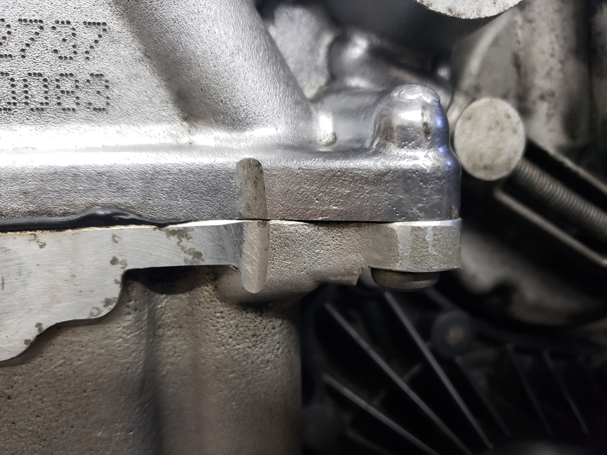

    The Leak
    Front Main Seal
    What a pain this was, Ill be sure to get the Audi special tool for this one next time, Ill be on the lookout for the tools (T40019 ; T40048). I wound up cutting most of the seal in half with a Xacto knife. FYI My seal puller I couldn't use until I cut the seal halfway because you cannot put pressure or mark the aluminum or crank surface by prying with a conventional puller.

    hello, have to replace a part that in your pics under heading 'the leak' 2nd pic is in the background, what is the black plastic part with the silver torx in it called? my bad jacked up car and did damage.
    thanks
    Oct 16 2021
    634047
    2010 A6 3.0T Prestige
    Gallitzin
    That is going to be your water pump housing, have a look on FCP Euro
    The plastic that you see is the back of water pump

    Good Morning, hope you have a long weekend and that its great.
    Sorry for the delay in my reply to your answer to my query its been a busy week.
    Thanks for the info and the link, sorted us out perfectly.
