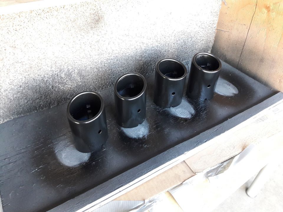

    Just as the title says, got tired of keeping the tips clean all the time so I ended up painting them gloss black. To my surprise, I think black tips are so much better than chrome in my opinion. Now I need to get black gloss badges to match it.
    Sanded and primed
    Painted and clear coated
    End results

    I think I’m going to go this route with my wife’s S3. Sick of seeing the tips filthy. Are the stock tips held in with hardware?
    It may be depending on the year. Mine are held by spring loaded clips. I sprayed liquid wrench silicone and let it sit for a few minutes then used a rubber mallet to slowly knock them off from behind. Once it moves, you can remove them by hand with a breeze.

    Quote Originally Posted by POPSS3 View Post
    POPS, looks great. What actual paint / products did you use? High heat engine enable or the super high temp header paint stuff? Is that glossy or a satin black?
    Apr 03 2018
    416548
    2018 S3, 2013 VW CC
    Quote Originally Posted by aaronc7 View Post
    Thanks! I just used VHT High Temp Gloss Black, Primer & Clear coat products. No need to use the super high heat.
    Jul 20 2019
    503592
    Thanks, that was my thinking as well. I just saw Rustoleum had a little DIY guide on their site and they recommend/use their equivalent 2000F high heat product. But it only has flat black option and has a much more involved cure process, I'll stick with the ~500F engine enamel paint.
    Apr 03 2018
    416548
    2018 S3, 2013 VW CC
    You are correct. I used the 500F VHT products. I scuffed up the chrome tips with 100 grit sand paper for better adhesion for the primer.
