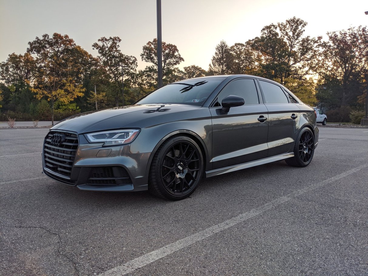

    Anyone with Mag ride running H&R super sports?

    Quote Originally Posted by a4000 View Post
    APR
    Looks good! I'm looking for a very modest drop, and yours is what I have in mind.

    Veteran Member Four Rings a4000's Avatar
    Nov 30 2004
    4316
    Pittsburgh
    Quote Originally Posted by normcaldwell View Post
    What are your wheel size/offset and tire sizes?
    19x8.5 et 40 245/35/19, I may go 255 next. Could also use a little spacer

    Active Member One Ring waddah's Avatar
    Dec 22 2019
    531476
    Jeddah
    this is my s3 with VWR springs and the springs aren't too harsh

    Quote Originally Posted by waddah View Post
    whats the specs on these stock wheels?
