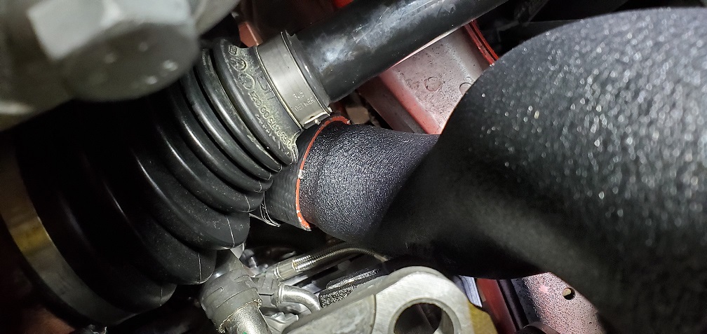

    Turbo Outlet Pipe
    Install notes: Fitment is not the greatest. The factory silicone pipes at either end did not give me the same amount of purchase as the factory pipe. Additionally, the bracket that mounts the pipe to the block seemed off. With the pipe adjusted to its best fit on the turbo and intercooler silicone pipes, it was a good 1/2" off on the block mount. I settled on bending the mount downward and using a few aluminum washers to space it out. This gave me an acceptable fit, but I'm not a fan of it. Removing the factory pipe from the silicone coupler on the turbo side was a pain. I recommend carefully prying the edge for as much of the circumference as you can, then carefully twist and move the pipe around to get it to let up. It seemed like once the edge let up, the rest of it did. This part took me a good 15 minutes, as I didn't want to cut the silicone with a small flathead screwdriver, or twist it too much. A plastic wedge/prybar would probably work great.
    Opinions: I installed this after driving with the throttle pipe for a few days. I think with both of them combined, there's a slightly improved throttle response.
