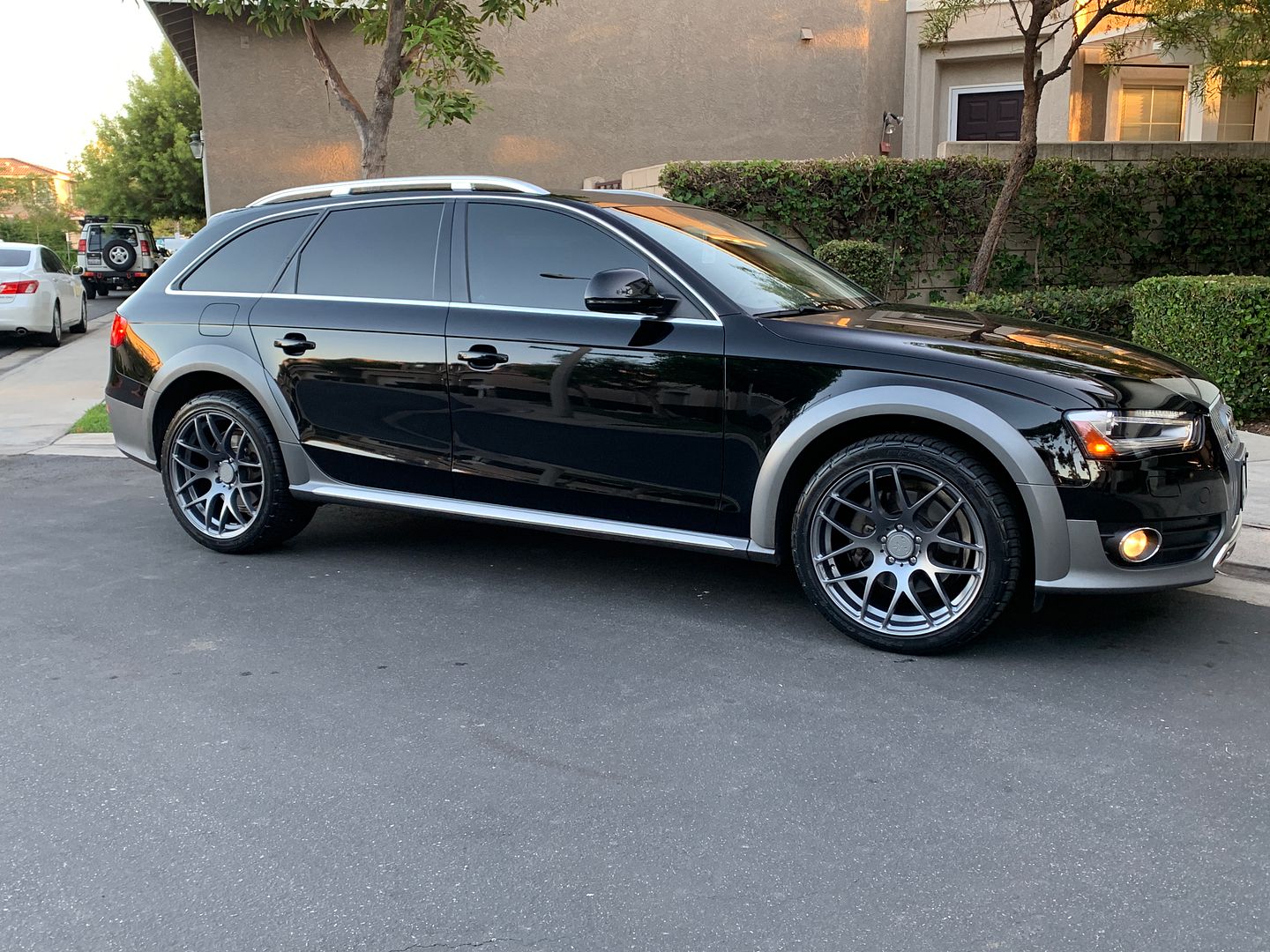

    I've looked through tons of threads regarding wheel size options for the B8 allroad, and keep finding posts regarding fender clearance but none addressing caliper clearance. My plan is to mount 19x9.5 wheels, with 275/35R19 G-FORCE COMP-2 A/S tires on a stock ride height 2015 Premium Plus allroad (see pic). I understand the stock offset for the OEM 18" wheels is ET26 (but that could be wrong), and my plan is to run the 19" wheels with a ET36 offset.
    Understanding the stock ride height, and no suspension mods, I think the tires will be fine relative to strut and fender lip clearance, but with the 10mm change inboard in offset, do I run the risk of rubbing the calipers?
    First time post, so thanks in advance for the help.

    Looks like it worked out perfectly. No rubbing, and flush with fender flares.

    Look great! Really like the wheel color, and how well it ties in with the lip, side skirt and fender flares. Any plans for future suspension mods?

    Will 19x9.5 with 275/40/19 tires fit on a stock allroad without rubbing
    Established Member Two Rings eurotuner123's Avatar
    May 15 2017
    399506
    1999 Audi A4 2.8 Sport (RIP) | 2010 Audi S4 Prestige Stage 1.5 (RIP) | 2014 A4 Allroad Stage 2
    Chicago,IL
    Quote Originally Posted by MacRoadie View Post
    I really love this setup and have been looking for this style and color wheel. Can you provide the wheel brand, model and spec? Thanks.
