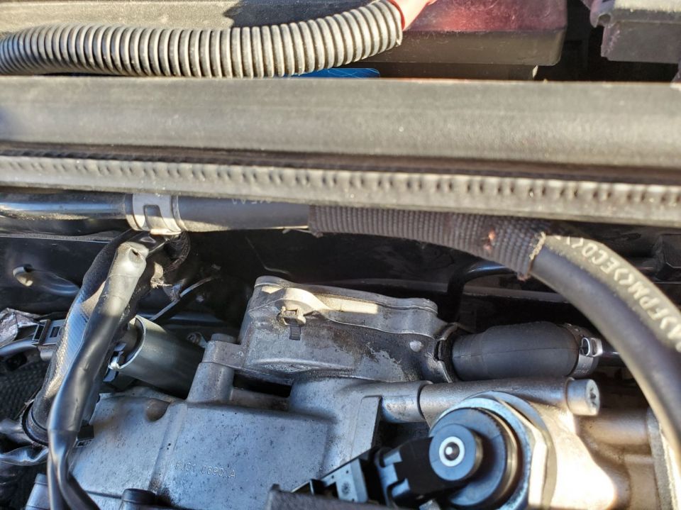

    Thanks for the input guys. I got some updates for you, but no solution yet. I took the ECU out today to check for corrosion or blown fuses and everything was clean under that box. I took a look at those 614 relays you mentioned EvolutionArmory, and I noticed some discoloration on the two main leads of the relays themselves. I assumed it was from heat or high current since it looked like when chrome exhaust turns blueish brown. I carefully took the caps off the relays to see if anything was burnt inside but all the components looked like they were new.
    I then wanted to probe the ECU connector and check continuity to the G410 connector. I gotta say those safety screws holding the ECU connector on were a pain, but not as bad as I was originally expecting. Using a T-pin that was too fat for the ECU coupler, I was only able to track down the VCC pin location, which looked a different color purple than what I was probing on the sensor connector (missing black stripe at ECU I think). From my experience I think it isn't uncommon for two or more sensors to share a common VCC pin at the ECU so maybe it T's off somewhere down the harness?
    I don't have a circuit diagram for this car, wish I had a Bentley manual or .pdf (wink wink), so that I could figure out if there are other sensors tied to this VCC that may be contributing to this voltage drop. I thought too that maybe my multimeter input resistance was throwing off my voltage readings. Usually happens with cheap ones, but my pride and joy of a tool Fluke DMM apparently has a 10M ohm input so I highly doubt that was the case. Unless that is Bosch put some circuit conditioning on that Vcc with an even larger resistance....
    Anyways, I decided to once and for all measure the fuel pressure at the HPFP to help me rule out clogged lines. I'm not sure if this was the correct procedure so please let me know if I should do a re-test (I'd rather not though). With my cheap fuel injection test kit I found the corresponding fitting to screw onto the schrader valve off of the HPFP and ran the engine. I then used the purge valve on the tester to remove as much air as I could, but the kit is crappy so I think it was sucking air in at the bleed button whenever I would hit it. Regardless though I was seeing the needle bounce between 5 and 5.5 bar at a rate that I imagine corresponded to the three lobes on the intake cam. So if the gauge is reading 5-5.5 bar then that would mean that the G410 sensor should theoretically show me 6-6.5 bar correct? I didn't have my buddy's VAGCOM at the time to check function blocks, but the CEL came on at some point during me testing the pressure so I doubt I would see anything different than before.
    When I get a chance I will find an actual probe small enough to fit in the ECU coupler and probe for continuity more thoroughly to see if there are any funky wiring issues, but I suspect not based on the car's condition. If anyone has a manual that shows the ECU wiring diagram, I would love to see what else if anything is connected to the Vcc line that G410 is on. My plan would be to unplug all those sensors and see if anything changes on the VCDS for group 103.
    Since I tested actual pressure at the brand new HPFP, my only options left are buying yet another G410, something funky with wiring, another sensor affecting the G410, or the damn ECU got fried on that circuit. If anyone has further suggestions that I may be missing please tell me, I'm all ears at this point.

    So I finally fixed my issue, and with a couple piecemeal wiring diagrams I found out that what I though was Vcc was actually the pull-up to 5V on the ECU signal input.
    Unfortunately the service manuals I found for an FSI stated that the G410 connector should have pin 1 reading ground, pin two ~0V for signal, and pin 3 5V for Vcc. Since I had already measured 5V on pin 2 I had assumed that somehow my wiring got crossed and signal was where power was supposed to be or something. Because of this I tried swapping the two wires in the connector and reading block 103 in VCDS to see if the fuel pressure was fixed, but unfortunately nothing changed.
    I also found out that the intake runner flap unit shares a common power and ground with the G410 sensor. I figured with out there being any flap codes I would check to see if I was getting the proper voltage at that connector. Sure enough I found 5v at the Vcc pin, but noticed that the wire color matched the wire color on my G410 connector that had 0V, and no continuity to ground.
    Fast forward to about a week ago, I was able to get a hold of someone who has another running FSI engine and I was able to measure correct voltages at the G410. This was where I found out that the low pressure fuel sensor has an internal pull-up in the ECU. For anyone else having a similar issue, note that pins 2 and 3 should BOTH have ~5V with reference to ground.
    Since I knew that my Vcc had 0V and no continuity to ground I figured I MUST have an open circuit between the intake runner flap and the G410. I started disconnecting sensors and pulling back the harness from back behind the timing chain cover and noticed a small rip in the thermal wiring loom. I then noticed that the cut went deep into electrical tape under the wire loom. Sure enough there was a little end of the white and black wire sticking out not connected to anything.
    Ultimately I soldered the two ends of the wire back together and heat-shrinked (heat-shrunk?) the wire and re wrapped the harness. Eagerly I read the 103 group values in VCDS and thankfully the fuel pressure values were right where they were supposed to be. Took the car for a few test drives to see if the code would come back, and so far the dash has been CEL free for a couple days now!
    I've had this car and CEL for over a year now and I believe I FINALLY got the cursed P0089 to go away. Unfortunately I wasn't able to figure out I had a wiring issue until after replacing both low and high pressure pumps, filter, and sensor.... but I was on the verge of buying a new ECU thinking the input A/D converter was fried, and thankfully I didn't.
    I just want to say I appreciate all the help from the forum, and I really wish Audi had better fault detection for open circuit condition. This should not have been a "pressure outside specified value" fault but more of an open/short fault code. I guess now I can start thinking about some go fast goodies, and knowing that a CEL will now mean something other than "Oh that? Yeah it's nothing" :D

    Any chance I could get a picture of where this is on the motor, I have the same code as well and it's making me want to sell the car. I'm losing my mind over this code! I have no power loss. It's given me a couple of misfires Once! And they were soft misfire codes. After clearing just the p0089 came up. I can't get this thing to go away and I'm not exactly super techy. I do not have vagcom as well so I'm kinda screwed someone please help :( I've read the insanely long p0089 thread and will be replacing my g410 but I'm terrified that's not going to fix it as the car runs completely fine.

    Quote Originally Posted by t_wicx View Post
    If you are referring to the HPUMP itself then yeah mc_hotmail's post can help.
    For the cut wire that I had, it was really hard to get good pictures since the wire harness is tucked between the head and the firewall pretty good. There wasn't much slack in the harness to pull it up and out to get a good picture but I'll post what I got.
    This one is just the general location of where my open circuit was. You can see the HPUMP on the bottom right, and vacuum pump on the top right. Essentially the cut in the wire was behind and under the vacuum pump in the big wire harness with the black heat resistant wrapping.
    This image is the actual wire that was cut. I had to pull the wire harness looming back quite a bit to get to the end of the white wire (5V reference to the G410). Again you can see the HPUMP in the photo, with the black plastic cap on the schrader valve used for pressure testing the fuel system. Was a tight squeeze to re-solder everything.
    I guess if you are having the same symptoms as me (no power loss or drive ability issues) replacing the G410 would be the easiest and cheapest option. Also check the part number to see if you still have an old revision of the sensor. Since they are known to fail it's not out of realm of possibility.
    Lastly for anyone electrically testing the harness, I just want to reiterate that there should be two pins that read ~5V when unplugged from the G410, and the 3rd one with continuity to ground. Until I found a second car to test on, it was never clear to me that the signal wire should be internally pulled up to 5 within the ECU. Makes sense in hindsight, but there was just no way for me to know for sure how the unit worked.
