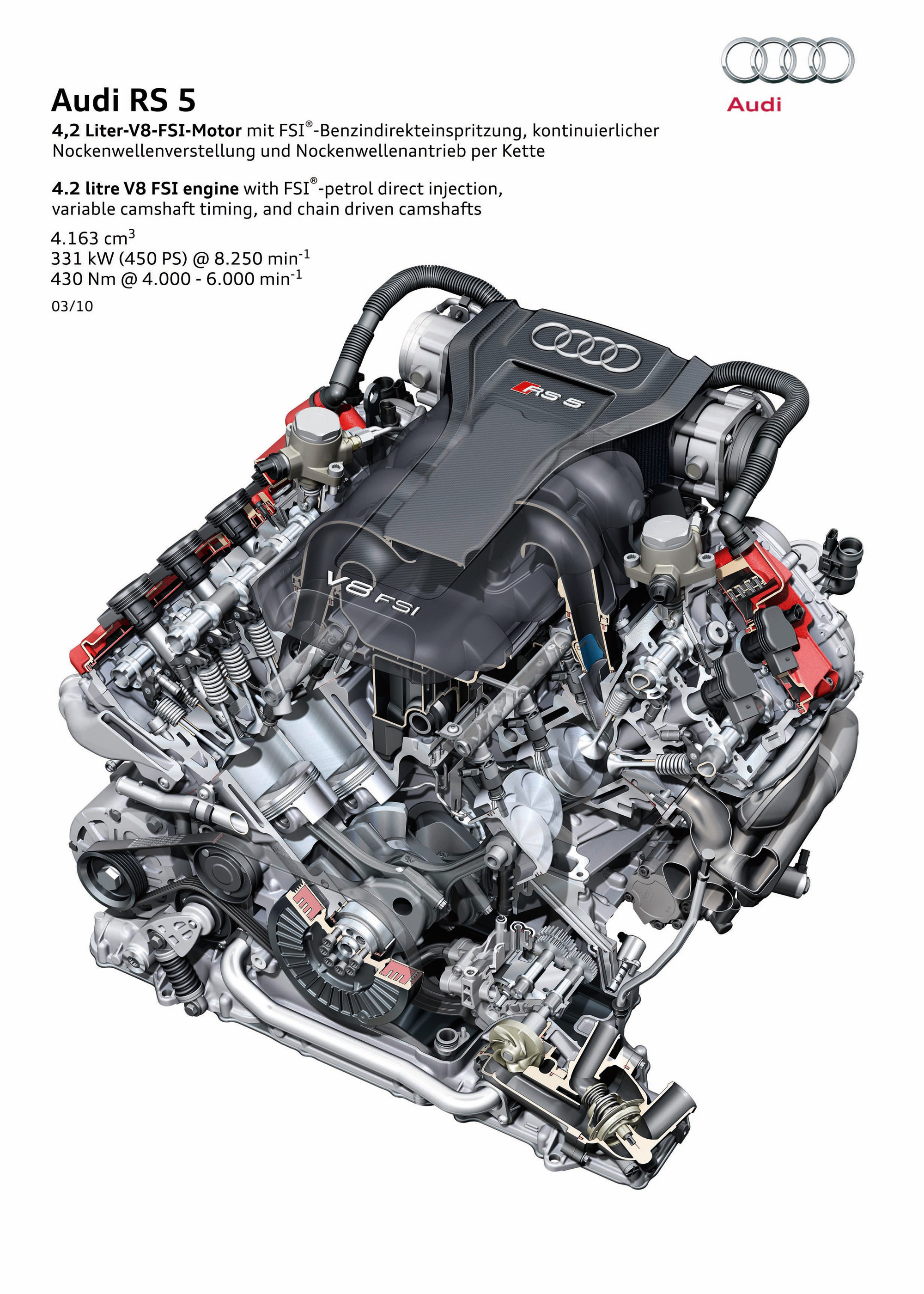

    Will do, thanks. Dumb question: does the air from the left and right intakes/throttle bodies mix in the intake manifold, or stay separate all the way through?

    I've yet to see an upper intake manifold opened up. I did find one single and very partial cutaway of the upper intake manifold and it looks as though there's a divider all the way down the middle. But...I just can't see the air entering on the left and right side, staying separate, and being shot into the intake port via what are really short intake runners. Granted, the RS5 is no torque monster but the runners must be longer than what the external shape of the UIM suggests. Usually, an intake manifold will "fold" the runners into an efficient labyrinth to increase runner length.
    In my head I feel like there should be some sort of a main balance chamber which feeds all the runners and would help equalize flow and pumping losses if there's a differentiation between sides for whatever reason. There's two of just about everything except for the MAP and IAT sensor. The MAP sensor is pretty much dead center in the middle of the upper intake manifold's forward edge. There are two throttle bodies because you get velocity at low rpm and flow at high rpm. My guess is air mixes from the left and right throttle bodies inside the upper intake manifold. That's my short answer.

    Btw I found this image: http://www.ausmotive.com/images2/Audi-RS5-90.jpg
    It looks like the UIM is an open chamber (mixing air from both throttle bodies) with flutes leading into the intake runner.
    Side note, but it looks like there there is an intake manifold runner control (the blue valve in the runner) that affects runner volume.
