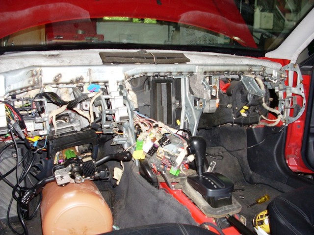

    I did that job on one of my B5's. I wouldn't call it hard. But it is very time consuming.
    Before I did that job I'd want to be very sure it is the evaporator that's leaking. Did the shop use dye, and then pull the blower motor so they could get a look at the evaporator to see the dye leaking? How did they come to their conclusion? I am not saying there is no way the evap could be the problem. But I have the feeling it's an educated guess. I'd sure want to know how they came to the conclusion. If they are right, it is a job you can do. You just have to be very methodical. But the truth is, these days a car without AC isn't worth much on the market.
