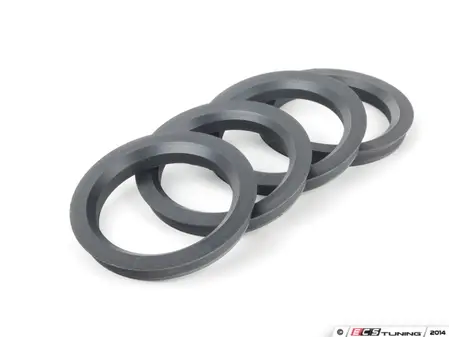

    Any chance that there is a set of hub adaptors already on there? EDIT: Or perhaps you need a set of these...
    https://www.ecstuning.com/Audi-B7_A4...Rings/72.62mm/

    @Kevin_C Now that someone has said it I don't think I have checked to see if there are hub adapterers that are stuck on the hubs of the car but I will when my wife returns with it.
    To everyone else who repiled the cars hubs seem to be too big for the stock Audi rims I purchased second hand. What Kevin said seems to be the most likely culprit and I feel stupid for not checking that first. Thank you everyone for your input.

    Ah, so the wheels that fit measure 72mm and the Audi ones you picked up have too small a hub bore. Kevin is almost certainly right then that the wheels came off and the hub adapters stayed on the hub then. Get them off and you're good to go, might be a task in itself.
