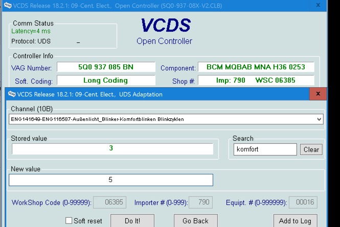

    Comfort Blinkers:
    09 - Central Electronics
    Enter access code 31347
    -Adaptation
    -Channel (2) Turn signal control Comfort flashing Select turn signal cycles
    -Adjust value accordingly - possible value range: 1-5
    *See below picture by el zorro..

    Blinkers from 3 to 5
