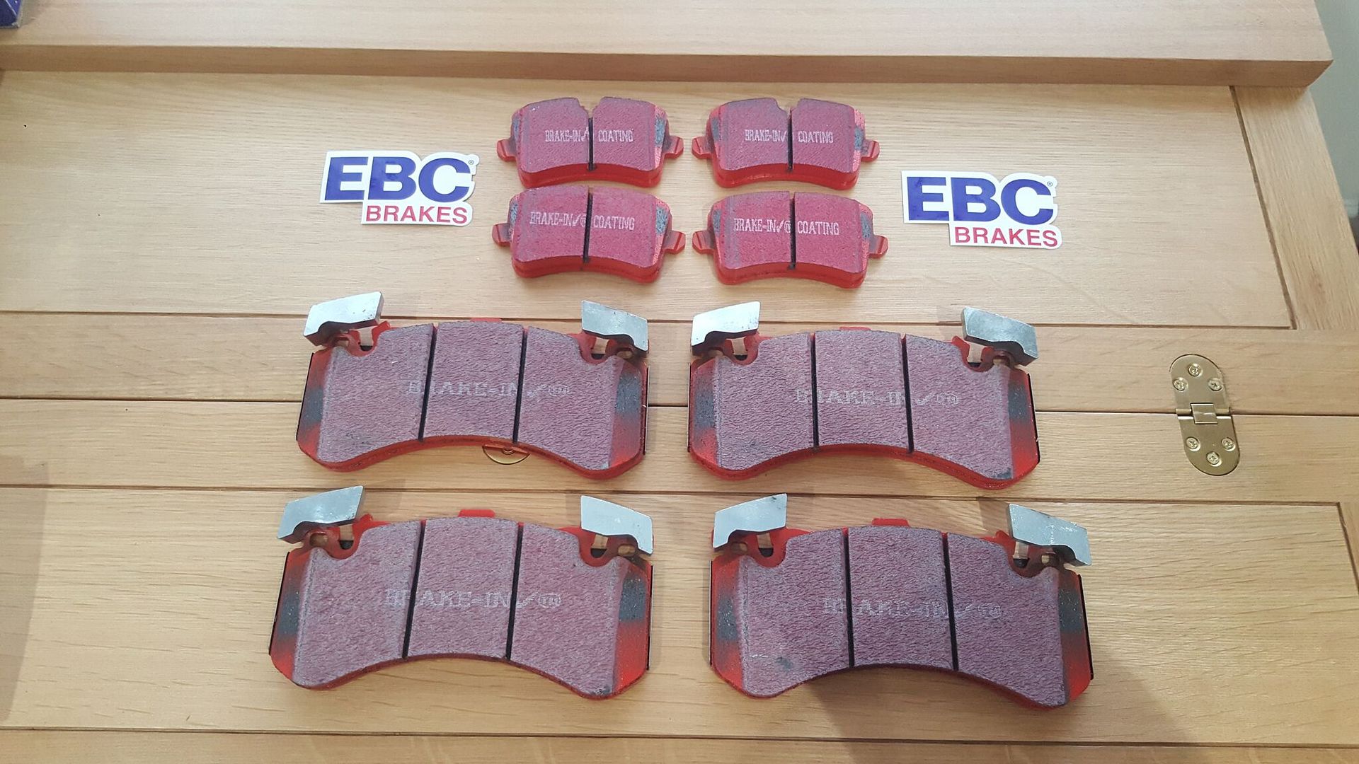

    EBC Redstuff.
    No squeal, very low dust.
