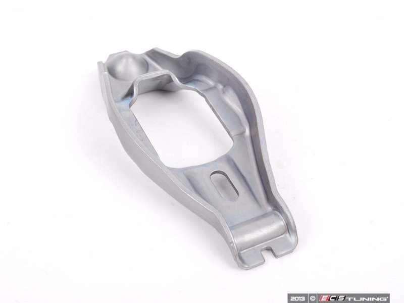

Anyone know the acceptable range of the distance from the outside of the slave cylinder to the point the slave would touch the clutch fork? Asking as I am pretty confident I have my slave installed and bleed correctly, however the first 1/2 of the pedal is good, then it is HARD. 1st slave blew up, I thought I had it installed wrong, thinking now that the distance is too far and the slave is over extending. Distance is approx 3" from outside of the slave hole, to the clutch fork. Vehicle has 111K miles. I bought it with the clutch stuck to the floor and what appeared to be a broken slave.....
I was hoping to get the car running to see what else it may need before pulling the engine/trans for repairs, but I may have clutch or PP issues it sounds like? If anyone knows that acceptable distance range it would be very helpful.
