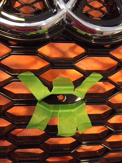

    I purchased the grille on June 25th, it shipped June 27th, and arrived at my doorstep July 3rd. Very quick transaction for a “made to order” Chinese product.
    I inspected it when it arrived and my initial impression is that it was perfectly acceptable for an eBay grille. Very similar to the grille I purchased form AliExpress which has held up great for the past 2 months. I am a bit of a perfectionist so there were a few things I wanted to alter before I installed.
    One, the little connections between each letter of the lower “Quattro" badge were silver where I felt they should be black to make the fact that the letters were connected less obvious. Two, I don’t plan on running a front plate so I Dremeled out the 3 blank mesh “cells” where the license plate is attached. This was tedious and nerve racking but it came out nicely. If you always lost playing Operation as a kid, I wouldn’t recommend this step.
    Third, and most frustrating, was coming up with a solution for the 2 awkwardly large mesh cells which were meant to hold the sensors which I opted to delete, initially. For some reason these 2 cells were larger than the rest of the mesh cells and stood out very obviously from certain angles without the sensors in them. Knowing this would annoy the piss out of me I decided to put the dummy sensor plates into the larger cells. The problem was that the sensor plates were much larger and not the same shape as the cells so I had to cut them to size. In the end, the cells stand out less now, even with dummy sensors in them, compared to what they would have looked like empty.
    Install and fit was great. Only complaint I have is that the paint doesn’t seem to be super tough. I observed a few minor marks but I was maneuvering it around quite a bit doing all my alterations, careful as I tried to be. I am just a little dubious how well it will hold up given its right in front taking all the abuse. We shall see, maybe I’ll be pleasantly surprised.
    Anyway, here are the pics:
    Taping up the quattro badge to paint the little connector sections black
    Taping off license plate mounts before Dremeling
    Grille after license plate mounts are Dremeled out and you can see the 2 large cells which would have held the sensors. Just too obvious to me.
    Finished product with the sensor plugs re-installed

    Just bought the same grill for my B8.5. Yup, this guy seems to be on the ball regarding shipping. Ordered on Sunday and he shipped yesterday. How was the bumper removal? Been trying to nail down a diy thread for this. Any tips? I asked if he would attach the S4 emblem. Did yours come attached or loose? What did you use to paint the inner silver bumper? Saw where someone used Rustoleum flat black engine paint but read some reviews that it dries more grey than black. BTW, looks good
    Removal was fine. It was my 2nd time doing it. I used these instructions. https://www.uspmotorsports.com/downl...structions.pdf
    I should have mentioned that I ended up using my oem S4 badge because the one he supplied, while it had the "S4" on it, used the backing plate for the "RS4" badge and was too big for the S4 letters imo.
    For the crash bar I used Rustoleum professional grade spray truck bed liner. I think I made the right decision. It is has stood up great and has just the right look being a matte finish. I just don't think palatidip would hold up well at all, nor would any type of paint.

    OP et al, I have recently ordered the RS4 style grille as well. How do I go about painting the front crash bar black?
    There must be a step by step diy soemewhere but really it's just
    1-remove bumper
    2-thoroughly clean crash bar
    3-rough up crash bar with sandpaper to prepare for paint
    4-tape off the entire front of the car except for the crash bar
    5-paint crash bar
    I went with Rustoleum professional grade truck bed liner spray. I did mine about 2 months ago when I installed my first RS grille and I inspected the bar when I just swapped over to the new grille. It has held up amazingly well over those 2 months (no chips whatsoever) and I'm on the highway 1.5 hrs each day. From my experience with both plastidip and paint, I feel like the truck bed liner is much stronger than either. It does have a slight texture to it, almost like an undercoating, but it is thick and perfectly matte.

    Thank you so much! Two more questions please:
    1. Do you think there is any added benefit to give a top layer of plasti-dip on top of the Rustoleum bed-liner or would that be an overkill?
    2. If I have to re-paint the grille for whatsoever reason (due to rock chips, gloss black to satin or matte black etc) what would be the best way to go about it? Call it preserving the look or damage control :)
    1-I don't see any benefit to adding palstidip over the Bed-liner since the Bed-liner is much tougher than the plastidip is. Plus the finish of the liner is similar to the dip, both are matte black.
    2-re painting the grille would be tough. But you can I believe separate the grille into pets (outer frame, lower frame, rings etc) to paint only what you need.
    I would honestly just touch it up if need be. From my experience and from what I can see from the haw grilles, the black mesh should hold up well. It's the aluminum colored frames I am thinking will need to be touched up. every now and then.
