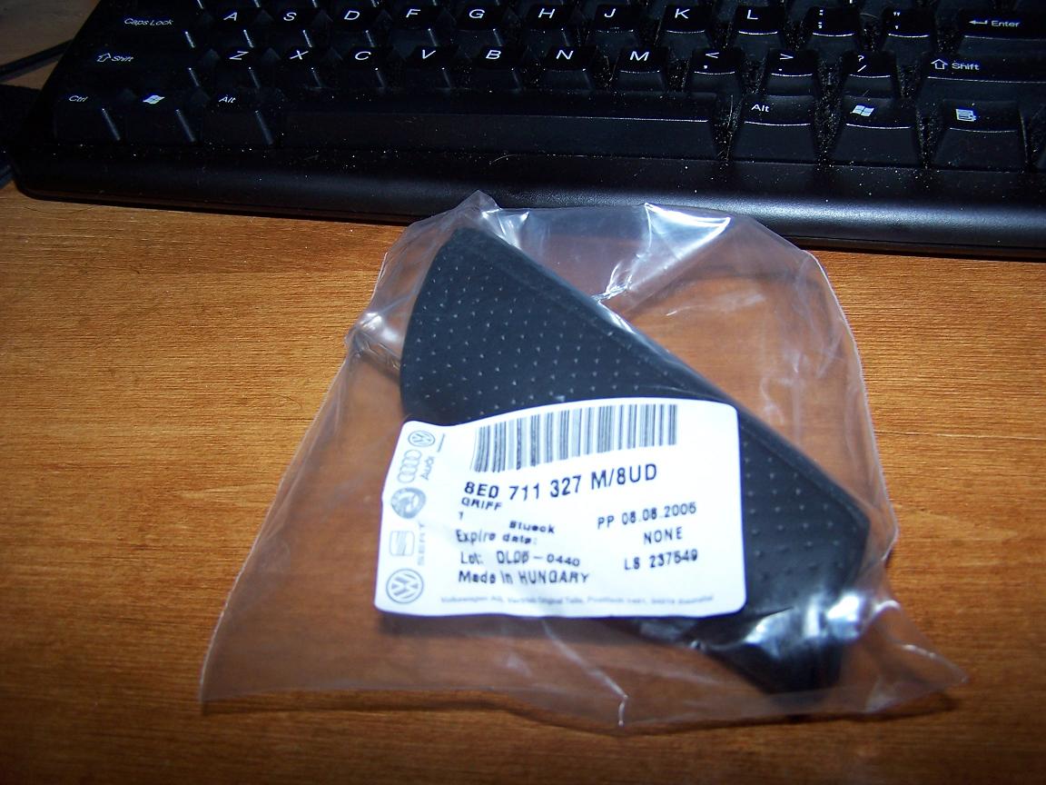

    My RS4 emergency brake (e-brake) handle arrived in the mail.
    Here it is out of the bag. Note the metal clip at the bottom, you'll need a long thin screwdriver to pry against that to take the old one off.

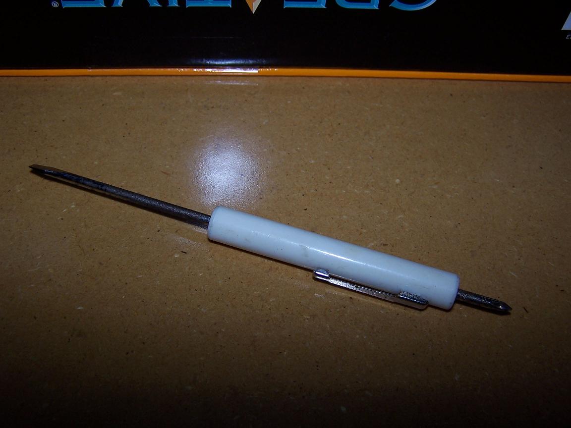

    Here's the tools used:

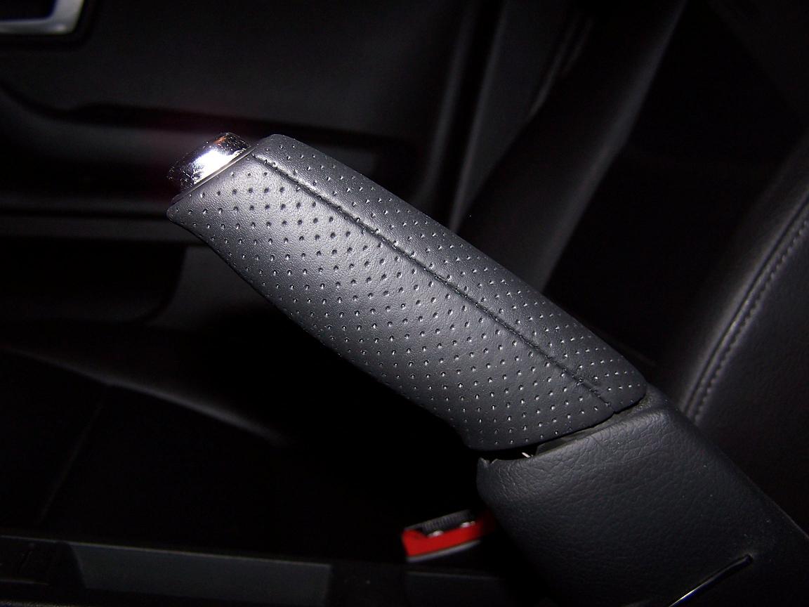

    Step 4: Slide the RS4 e-brake cover back on making sure the metal tab clips back in.
    RS4 e-brake installed (yes the car is very dirty... it's well below freezing with snow and ice in Ohio):
    It goes perfectly with the Ultrasport interior... especially the shift knob and the steering wheel which also has the perforated leather (a.k.a. air leather):
    That's it. Takes 5 minutes to do from start to end.
