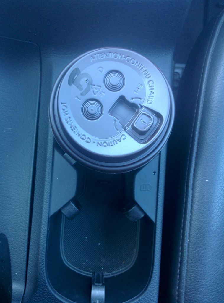

    B7 Center console, as we all know. Do it for the cup holders. Be sure to get the E-brake assembly, can be done without it...but no cutting required with the B7 assembly.

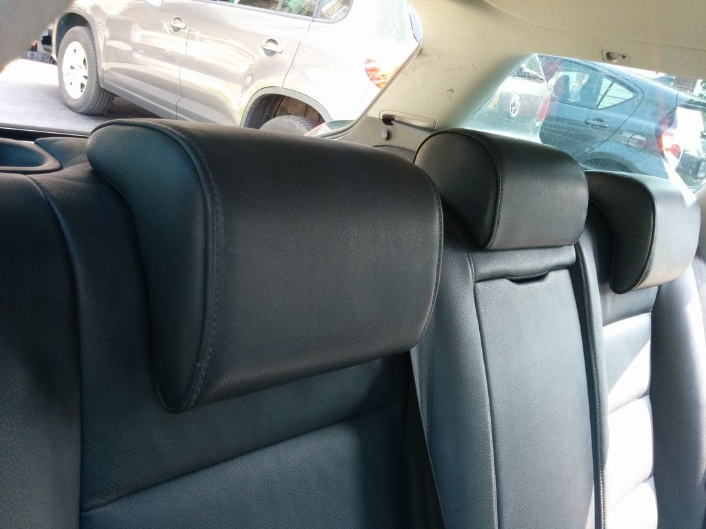

    B7 rear headrests. Cleaner look, IMHO.

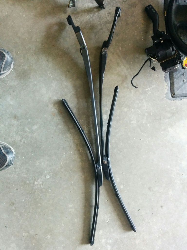

    B7 Aero wiper arms/blades. You may already have these on your B6 if it is a late 2004 or a 2005.
