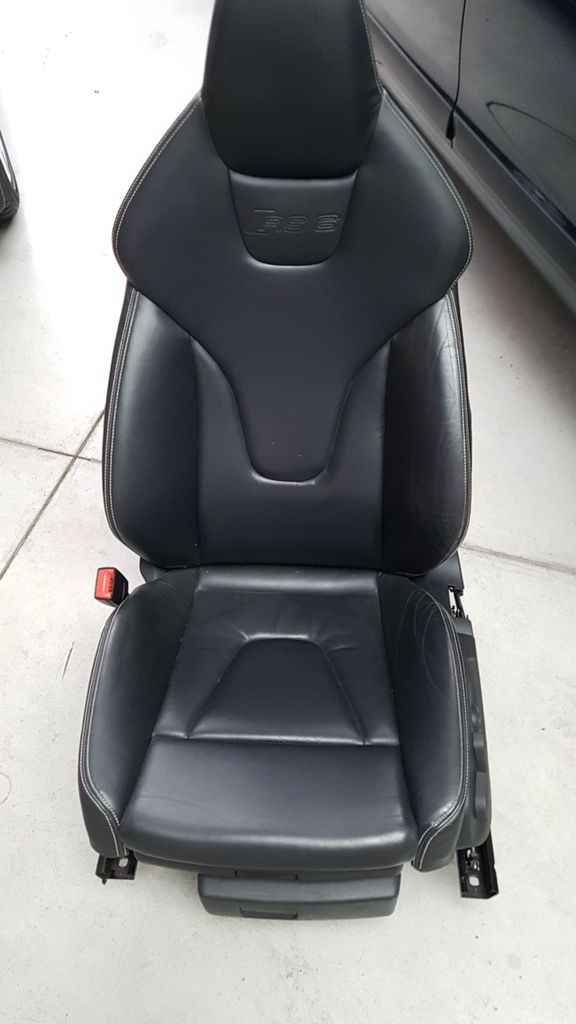

    And last one for 2016 was front+back seats from rs6 and door panels.
    Here are some pictures whit the interior.
    And for 2017 I have big plans let's hope everything goes well like in my mind.
