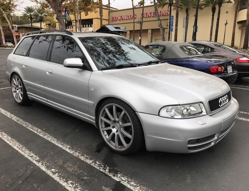

    I bought the avant for my dog. But girls actually like it.
    Yea, it may have been a stored code. VCDS usually clears stuff and never shows again after resolved but it seems that your scan tool handled it.

    Here's mine...
    Quote Originally Posted by Audi of America
    There were 997 2001 Audi A4 Avants 1.8T with the 5-Speed manual transmission/Quattro sold in the U.S.
    There were 456 2001 Audi A4 Avants 1.8T with the 5-Speed manual transmission/Quattro with light silver metallic exteriors sold in the U.S.
    Lastly, there were 334 2001 Audi A4 Avants 1.8T with the 5-Speed manual transmission/Quattro with light silver metallic exteriors and onyx interiors sold in the U.S.
    I guess mine is more rare than yours but nothing close like the India Red avant.
