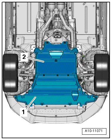

    2. Remove the belly pan by removing the 8 belly pan screws with a flat or philips head screwdriver - 2 in the front, and 3 on each side near the fender liner (red), and loosening the 3 belly pan screws at the back of the belly pan (orange). Edit: It has come to my attention that your car probably has a rear belly pan also. Mine only has the front one. Remove both if you have them.

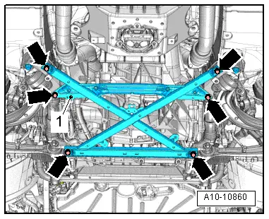

    3. Remove the cross-brace support under the transmission pan by removing the 6 18mm bolts holding it to the subframe (green). You will need to remove a 10mm nut attaching the power steering line to the top of this brace before it can be removed.
      You should now have this:

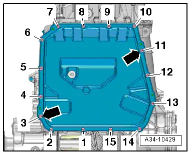

    6. Start removing the 15 T30 transmission pan bolts, being sure to leave one partially installed as well as one on the opposite side, so that the pan will remain in place until you are prepared to remove it.
    7. Carefully remove the last two bolts while holding the transmission pan up. Lower the pan and dump the fluid into your bucket. I wasn't fully prepared for how much fluid was left in the pan after draining, and made a bit of a mess.

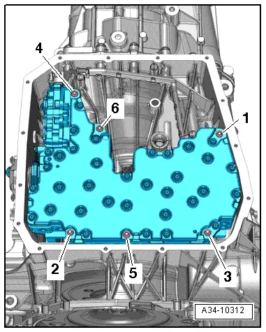

      You'll now have this:
      You can see the filter you need to remove. Reach in and pull the filter back toward the rear of the car to free the filter. There's nothing else holding it in; it will pull right out.

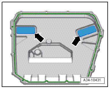

    11. Take this time to clean up your transmission pan, now that it's been removed. Clean any residue off of the two magnets, and thoroughly clean the gasket seating surface. Mine had lots of silicone residue from where I guess the last person performing the service went a little overboard.

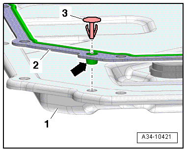

    12. Open the packaging for your gasket, and apply it to the pan. It has a few rubber pegs that fit into holes in the pan's flange. You will see I have already installed the new drain plug - I haven't torqued it yet, just screwed it in place with the new crush washer.
    13. Here's the trickiest part of the whole job. Remember how the filter inside the transmission was seemingly not held in by anything, but was probably holding its position? You will need to install the new filter such that it will hold its position at least long enough for you to get the pan back in place.
      The tiny o-ring listed above actually goes around the "+" that is coming out of the top of the filter, and that "+" then fits into the bright silver colored round mount inside the transmission - but it won't HOLD it there. The o-ring is seemingly only to reduce vibration/movement.
      I noticed that the filter immediately sagged once installed, before I could get the pan on. I was able to "fix it" by cleaning the filter's orange rubber seal and its mating surface in the transmission with brake cleaner to make it "clean and dry", rather than coated in oil like you imagine you'd want it. Now it holds its position pretty well. One the pan is on, it won't be able to move. Sorry I don't have better pictures of this - but it's pretty obvious where it goes if you see it in person.
    14. Raise the pan into place, and screw in at least two screws on opposite sides, to hold the pan up. If you don't screw these in all the way, the pan will be able to drop a little, and the filter may move out of place. A helper to hold the pan in place while you put a couple of the screws in is recommended. Screw them all the way in so the pan doesn't move, but do not apply any torque.
    15. Screw in the remaining 13 transmission pan bolts, then torque them down in a criss-cross pattern. I believe the torque value for these is 10nm, but I have read online that it may be advisable to apply more like 12-14nm of torque. Unfortunately, I didn't have a working torque wrench in that range, so I tightened them all down to approximately 10nm, then went back over all of them for a couple more passes, increasing the torque a bit more. I could tell that the bolts were soft, and wouldn't take much torque. They were also probably not replaced last time - it was now that I wished I had purchased replacements. Fortunately I haven't had any leakage yet (without any additional silicone sealant) - but I will definitely replace the bolts next time.

    4. Expanding Rivet
    􀁺 For attaching the gasket to the ATF oil pan 􀁺 Not required for installation
    5. Magnet
    􀁺 Quantity: 2 􀁺 Insert into the depression in the ATF oil pan 􀁺 Make sure the entire surface contacts oil pan

    Code:
    Fig. 2: Identifying ATF Oil Pan, Tightening Sequence
    Courtesy of AUDI OF AMERICA, LLC
    -- Tighten bolts in 2 stages as follows:
    -- Install the bolts -arrows- hand-tight.
    -- Tighten the bolts -1 through 15- diagonally to 10 Nm and in steps.
    Code:
    Fig. 3: Identifying Mechatronic, Tightening Sequence
    -- Tighten the bolts to 10 Nm in the following sequence: -1 to 6-.
