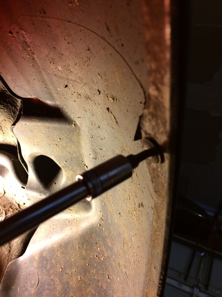

    STEP 1. Remove driver's side wheel.
    Step 2. Remove all the little torx head bolts holding in the fender lining.

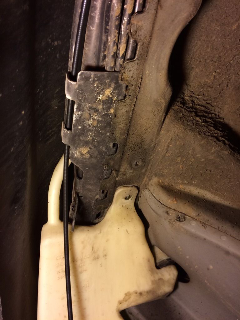

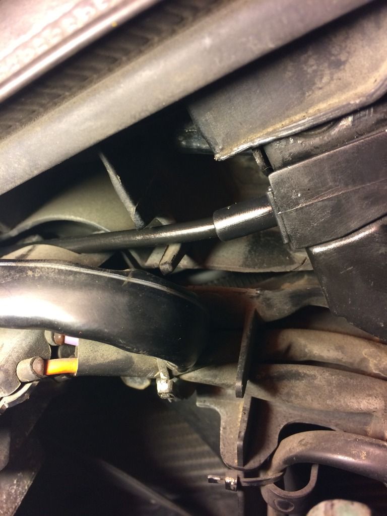

    STEP 3 Locate the rubber grommet where the cable feeds through. It is the bottom of the two large lines going through the body. You can see where mine began to prolapse from a hasty and improper removal. (lol)

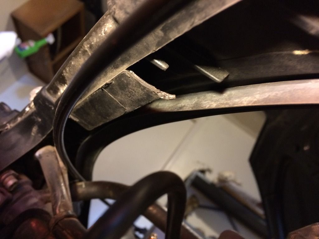

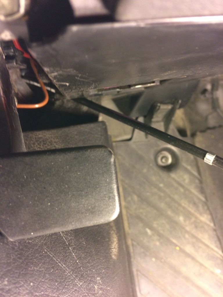

    STEP 4. Feed the line through the hole provided. When inside the car, this is where it will come out:

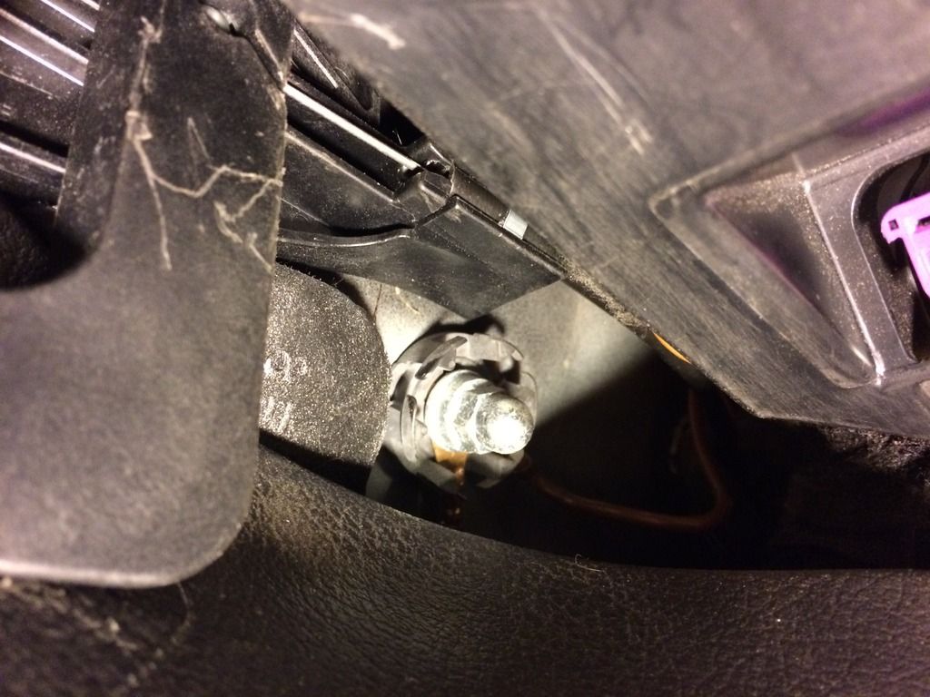

    STEP 5. Line it up, and install it on your release lever. You can see in the picture that my line isn't all the way pressed in. Do not leave it like that. (No, I didn't have to learn the hard way)

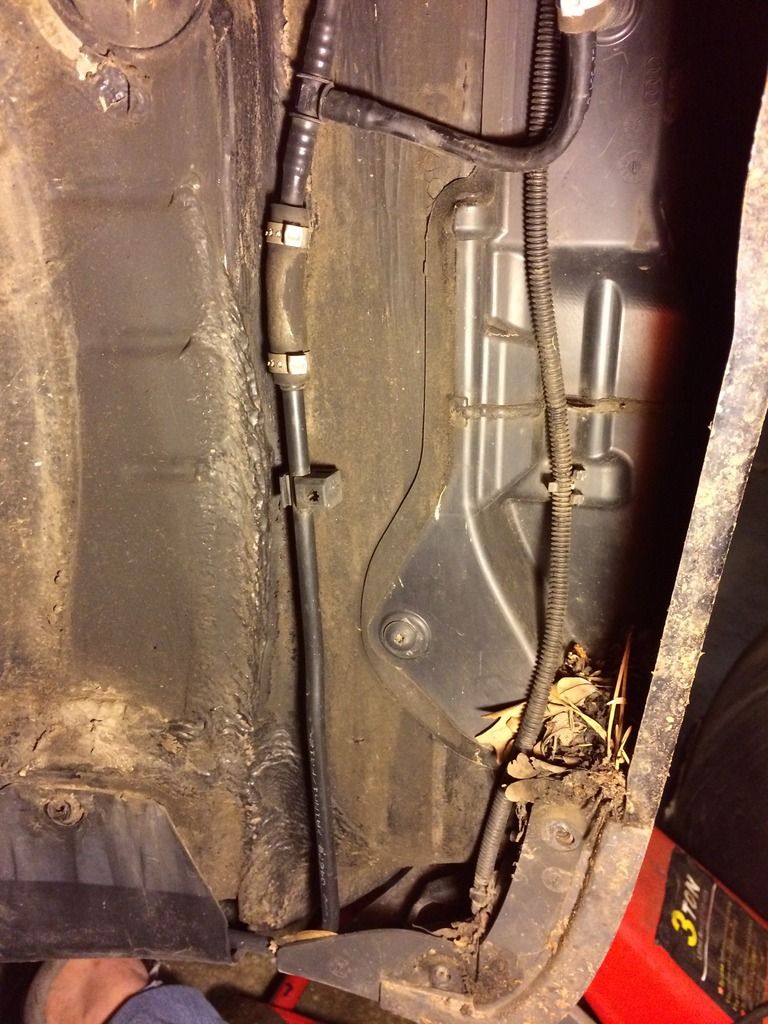

    STEP 6 Begin to run your line through the wheel well, following the rest of the lines going that way:
    STEP 7 I have heard of people mentioning that the washer reservoir needs to be removed. I did NOT remove mine. Instead, I pulled my headlight out (much easier), and pulled the line out through the front of the car, and curved around, following its normal line.
    STEP 8 Tuck the cable as much as possible, following the factory routing. If done properly, the cable should line up with the release mechanism fairly well.

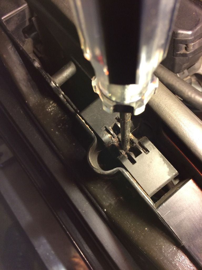

    STEP 9 Stick a screwdriver down in the hood latch to lock it down. It will make your life SO much easier when trying to hook up this end.
    STEP 10 Secure the cable to the mechanism. It should go right into place if you have it locked, and it will make a slight snap/pop from the plastic setting where it needs to be.
