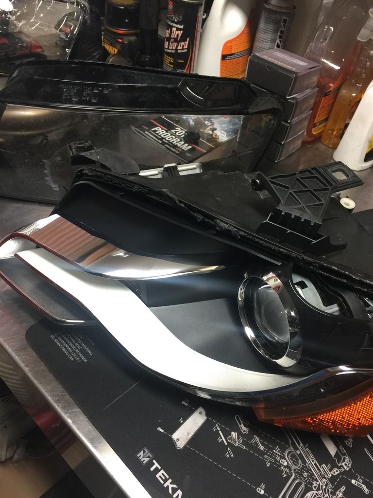

    Did mine the other night. Only took about an hour a side.
    Couldn't figure out how to pull the guts of the lamps without breaking every tab and bracket. So they got the amber lens delete and buttoned them back up.

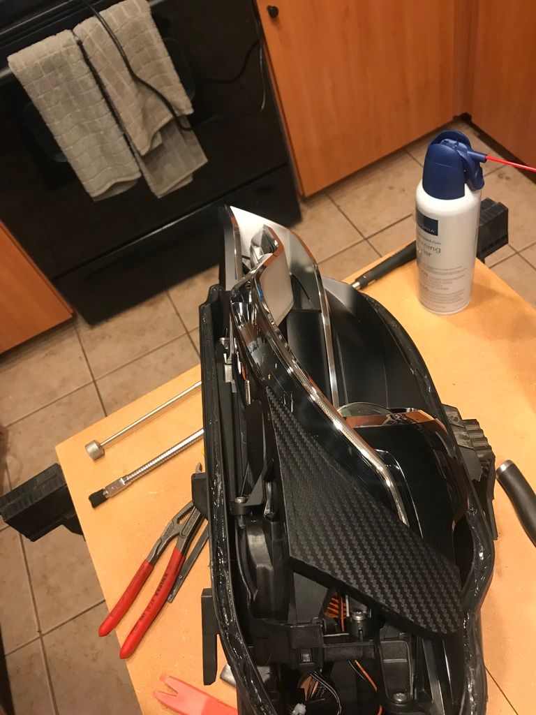

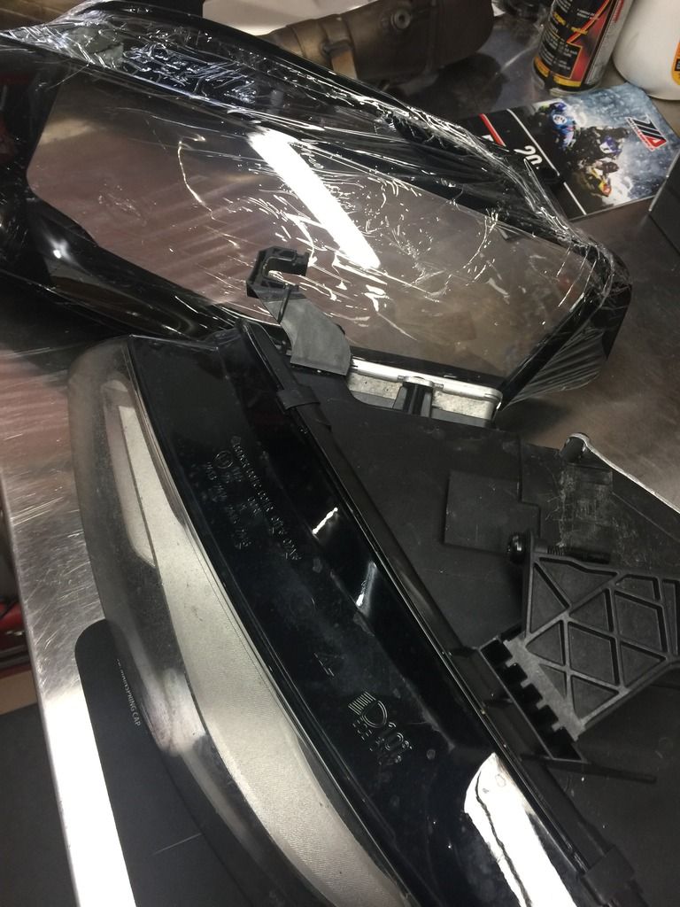

    I'm about to do a walk though on how to replace the lenses and pull everything apart.
    First time using a heat gun too. Literally took me 3 minutes to pull the headlights apart. 3 goddamn minutes.
    My old car I did them in the oven. Turned it to 200 till preheat. Turned it off and put one in on a towel for 5-10 minutes came apart easy but didn't want to risk it with the Audi and all the electrical things inside. My old car didn't have any of that stuff.
    I've literally pulled these headlight lenses 4 times over the last two days. That's the easiest part.

    So what is everyone's technique for the heat gun to remove the lenses?
    Which setting?
    How far away to hold it from the lens?
    How long to hold it before moving on to the next section?
    Please forgive my noobness. I'm going to buy a heat gun and new lenses soon! Mine are kind of trashed after 75000 miles.
    Veteran Member Four Rings Lambda13's Avatar
    Jul 07 2012
    96422
    A4, car parts, paint, random sockets, OEM parts.
    Boston, MA
    Quote Originally Posted by A4x View Post
    Which setting?
    I just run it over the glue a few times around and then begin to pull the lense while giving it additional heat. Stay at least 6 inches away from the plastic.
    Sent from my SM-N920V using Tapatalk
    My 2009 A4 Prem+ Build thread
    May 02 2017
    398801
    phoenix
    Which setting?
    i used 1000 degree setting and was 4-6 inches away for a few seconds. One pass over the top and side. Flipped over did the same thing.then flipped it back over and did a quick pass on the whole headlight. Took under 5 minutes to take them off. Easy
    Be careful how you pull too i got some glue on the side of the inside parts( not really visible but i removed it). Pull up one side a little then the other side then grab by the middle and pull it straight out.

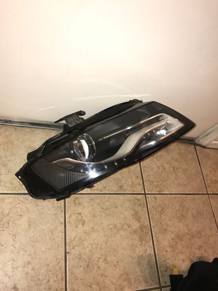

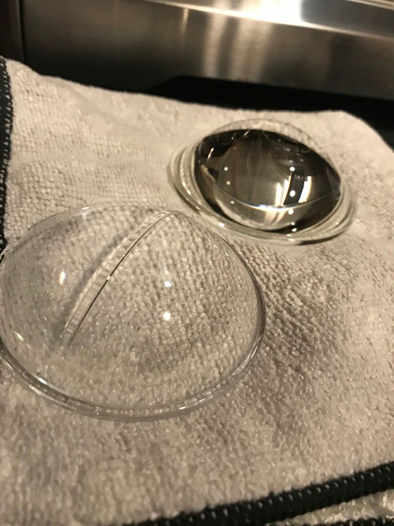

    heres some pics of the cutoff i got out of the stock housing with clear lenses and one washer per each bolt. Adjusted the adjustment bulb with the lenses off both sides where different there but got them to look the same. Cf wrapped the side marker. I attempted to restore the headlights from major rock chip damage and they aren't much better. Ill probably end up going with these lenses sometime this week.

    Veteran Member Four Rings Zach L's Avatar
    Feb 23 2010
    55071
    Austin, TX
    Quote Originally Posted by elijahscott View Post
    Wow, congrats! That is insane how much brighter and sharper it is with the clear glass lenses and the new plastic housing lenses. The comparison shot of the new one of the right and the old on the left is perfect.
    Did you also put a new bulb in on just the right side, or is it the same as the bulb on the left?
    Feb 23 2010
    55071
    Austin, TX
    Quote Originally Posted by Lambda13 View Post
    What lenses are you talking about? I hate the light output I have on my e-codes. Sometimes I feel like I have no lights at all...
    The glass lens on the front of the actual projectors in each headlight. All light output passes directly through these projector lenses, so they control the brightness, the color, the direction and diffusion, and the cutoff of the light output. From the factory, the projector lenses are cloudy, tinted yellow, have small dimples to spread light, and they have a horizontal line right through the middle which blurs the cutoff. The factory lenses alter the color of the light and destroy the blue/purple flicker you see on most higher end Japanese vehicles.
    The main difference with E-codes is that the glass lense is slightly better than the US-spec ones. It doesn't have quite as many dimples, but it still hurts light output significantly. It's why people with even E-codes still do clear lens upgrades. The ZKW-R lenses only cost $40 and are a vast improvement for both US-spec lights and E-codes. There's really no point to E-codes when the US-spec lights can be upgraded for a mere $40 and have far superior light output to E-codes.
    There is no bulb that can improve light output anywhere near as much as a projector lens upgrade. The pics from elijahscott above in this thread show the huge improvement.
    Here's the lenses: http://www.lightwerkz.net/index.php/...lear-lens.html
    Clear glass projector lens swaps are a more complex install. Here's a DIY with a boatload of pics: http://www.audizine.com/forum/showthread.php?t=708079
