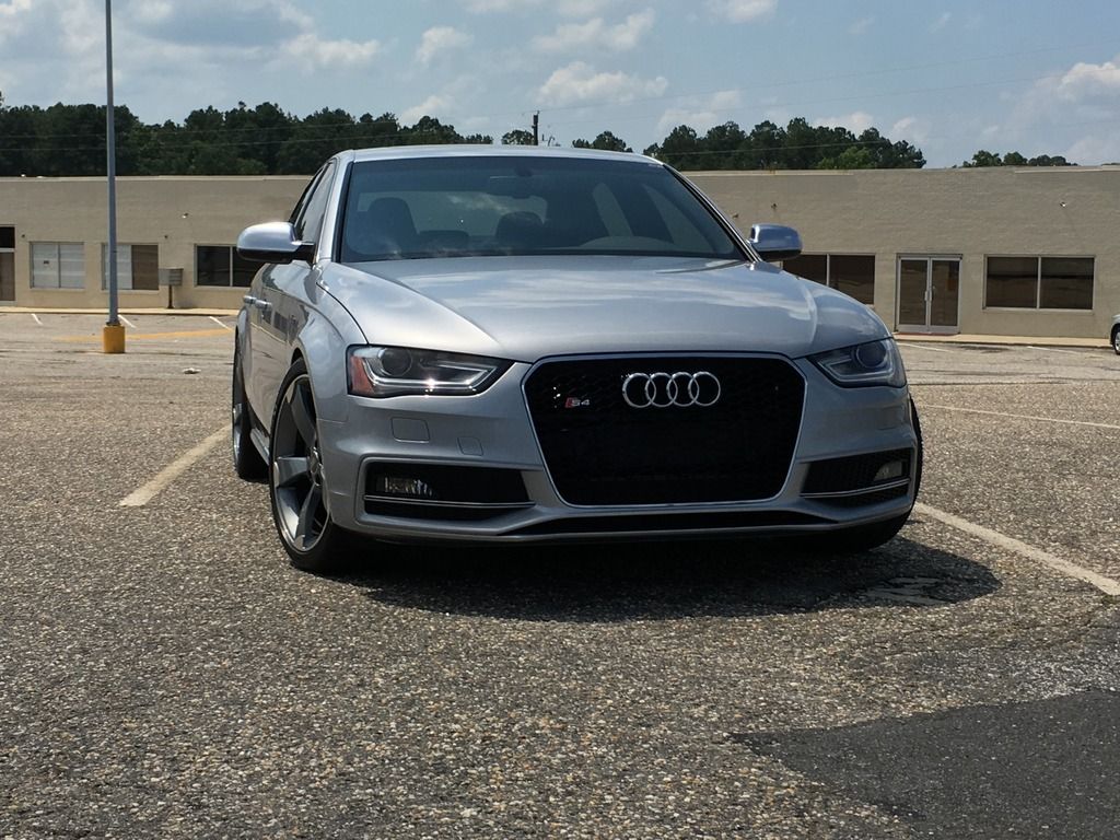

    2015 B8.5 On Sport OE and stock shocks (granted quite new when H&R installed) but no bounce - so you can stick w/original shocks...mileage may vary but eventually they will be replaced
    Another factor to consider is tire manufacturer / tire side wall profile - they do vary...and as you notice the PSS has a VERY square profile so it eats up ALOT of that fender gap / next being the wheel ET
    mine is a 35ET PSS 255/35-19:
    [IMG][/IMG]

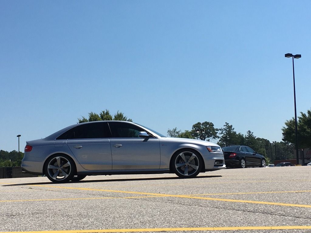

    [IMG][/IMG]

    ^ Have you posted any profile shots of your car sitting on a flat surface, and if so could you provide a link?
    SOLD 2015 Daytona Gray S4
    Veteran Member Three Rings bayonet14's Avatar
    Aug 07 2013
    120474
    BMW 335i
    Pinelands NC
    Quote Originally Posted by SteveYem View Post
    You got it

    Thank you! Looks great. I may be getting convinced..

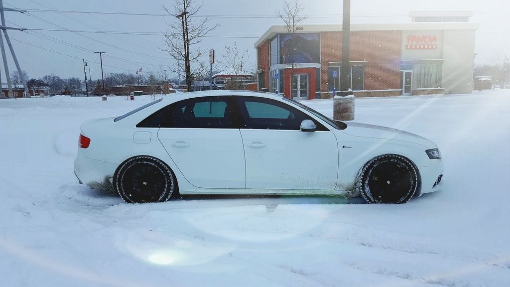

    H&R Sport Springs with Bilstein HD Shocks. I get the occasional rub if the car is loaded with heavy ass .NET software engineers haha.
    I ran ST coilovers on my B8 A4 before this which is suppose to be KW V1 equivalents with shittier materials. The ride is night and day in comfort and ride.

    I'm running H&R sport springs and I do get occasional rub. But my wheels are also 20x10 et40. If you are getting the sport springs I would definitely get adjustable control arms as well.
