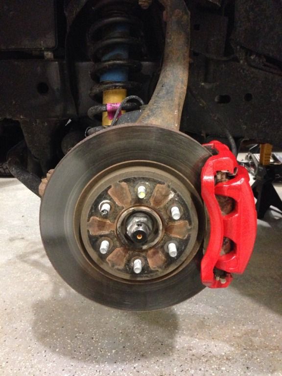

    Used VHT caliper spray almost two years ago and it still looks fantastic! Easy DIY.
    edit: just saw you guys ragging on colored calipers hope ya don't mind my pics!

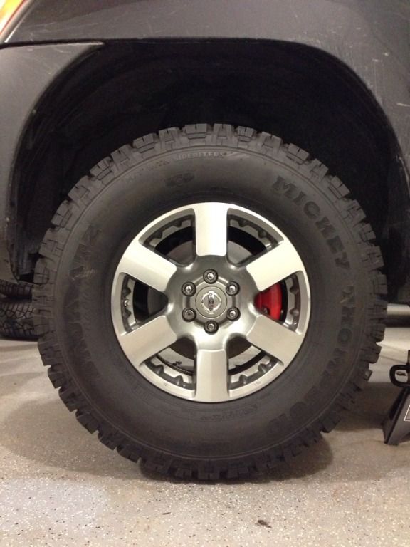

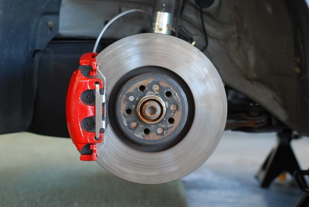

    I used Rust-Oleum red caliper paint and some Rust-Oleum High Temp clear coat. My fronts have a bit of brake dust marring, backs are perfect still. Fronts look a bit faded from the brake dust that just won't come off, but overall still very nice.
