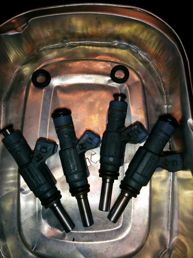

    I know O rings dry and harden over time and I was wondering if there is a product that can be applied/soaked to bring back some life to them?
    I also know finding the correct o rings for TT225 injectors can be a pain so that is why I would like to re use these ones if possible.

    I would just replace them. Don't know of any product to restore them. And when you find the correct O-rings save the part number for future reference.

    Just get standard injector o-rings from any auto parts store. Order them for your car.

    They are 3.53 x 7.52mm O-rings. Which is actually a (british) imperial size, BS 203
    Nominally 5/16 ID, 9/16 OD, 1/8 c/s

    Found another forum post where guy says brake fluid restores O-rings. I don't see how.
    IDK.
    But I have tried to maintain them with DC111. I think my stock injector O-rings came with something else. But otherwise I've used that.

    dow corning 55 (molykote) lubricates and swells orings

    Quote Originally Posted by 5ktq View Post
    Are these specs for the intake or spray side of the injectors?

    Oh that was for stock, same both ends. Is TT different? I missed that

    so is the top and bottom o ring on a TT injector different sizes? if so...Do I keep these 2 different sizes when I install in a b6 A4 fuel rail?
    I found this info...
    Top o rings are the same.
    OEM 1.8T injector lower 7.5mmx3.5mm
    OEM 1.8T 225 Injector Lower 9.3mmx2.6mm
    Lower-06A 906 149A (what lower, 1.8t or TT225?)
    Upper-035 906 149A (the same between 1.8t and tt225)

    I think the 035 part is the normal one (for both sides of normal injector). TT must be different, if it is indeed different.
    These are the stock O-rings. $5 each is insanity. 20 / $2.70 much more sane.
    https://www.motioncanada.ca/productD...p?sku=00619879
    motion has locations all over canada, industrial supplier. Used to be called 'bearing and transmission', at least out here. But i'd think any industrial bearing / seal outfit local to you should be able to get you a '203' o-ring.
    Youll have to cross that different size lower TT one and try and get it for reasonable price too.
