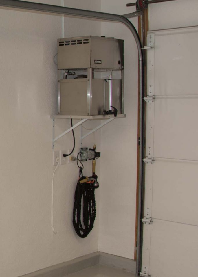

    I know this is not the forum for a Car Washing Tip BUT there are a few guys on this thread who are VERY particular about keeping the appearance of their A6/S6/A7/S7/RS7 PERFECT so I thought I would pass this on.
    This is THE solution to not only keeping your car looking great but over time keeping the residual white crusty crap from building up, particularly on black surfaces, plus it's also a huge time saver.
    I use a "10 Gallon Water Distiller" (with a small pump and hose) for the final rinse after washing my car. This is not a water filter or soft water (which do not capture all the minerals) it's the real deal.....100% pure water.
    Because distilled water has "zero minerals", after you rinse the car you are done......period. Pull the car back in the garage and let it drip dry.
    Although it's hard to walk away from a soaking wet car (the first time) when you come back a few hours later....it will be spotless and dry- glass and paint.
    Not only does it require less work but you will NEVER get white mineral build up.

    wow impressive, never heard of this.. no drying? sounds amazing

    Nice idea. Cost more or less than this?
    http://www.autogeek.net/cr-spotless-water-systems.html

    $1,500.
    I have never compared other water purification systems to the unit I use but ANY minerals whatsoever will leave a spot. A "true" distiller produces pure water by evaporation which takes longer (20 hours for 10 gallons) and costs more- I use about 5 gallons per rinse. It's hard to believe that you can filter 100% of the minerals out of water with a simple filter, however this would be a good research topic.

    You can, it's not a simple filter it's a deionizer, makes similar water but through ion exchange versus distillation. The two waters are used interchangeably for many things.

    I have been using the CR Spotless system for over 10 years. Works like a champ provided you change out the resin once a year. I also use a Master Blaster high powered, heated blower to finish it off. No towel of any sort is used, except for door jambs, etc. I got mine from Costco online.

    On detailing sites I see replacement cartridges and granular resin available. I presume both are "refresh" options. Is that accurate? Which do you recommend?

    I've been highly considering this. The water in Las Vegas is so hard and causes so many water spots that makes washing the car such a bear.

    The cartridges are re-useable, buying the resin only will save you money. Just refill the cartridges. You can buy pre-filled cartridges if you prefer.
