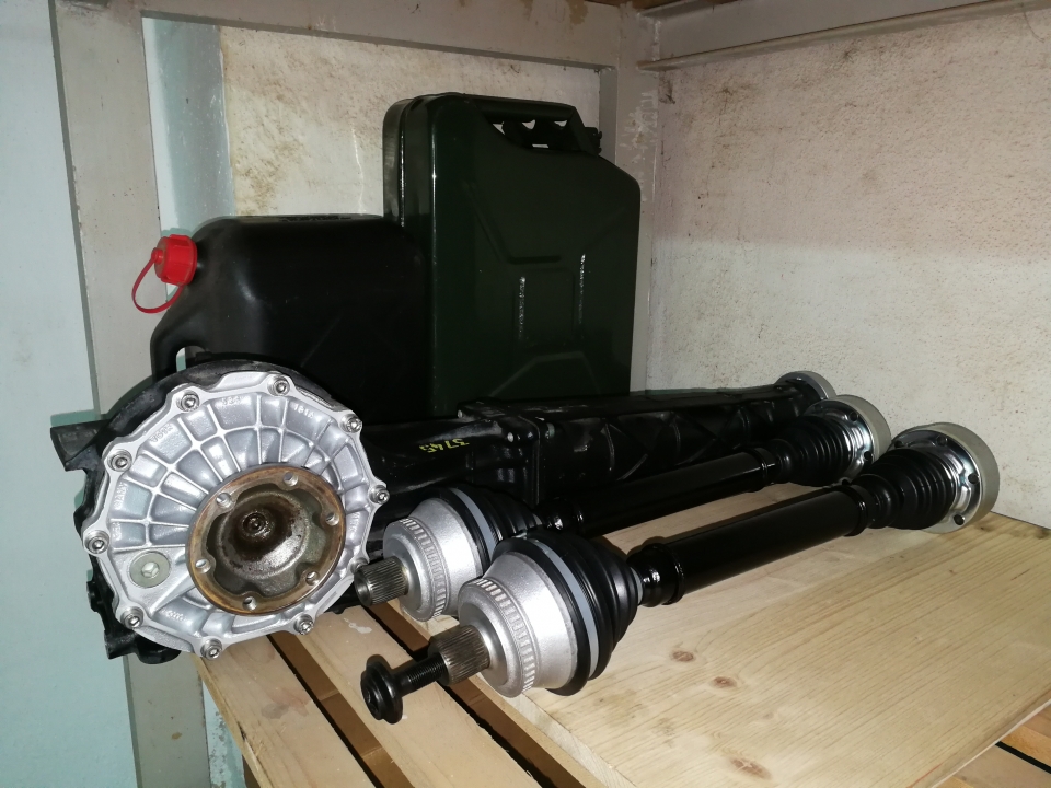

    Did i said, that i refreshed the reardiff. and the driveshafts too ? If not...
