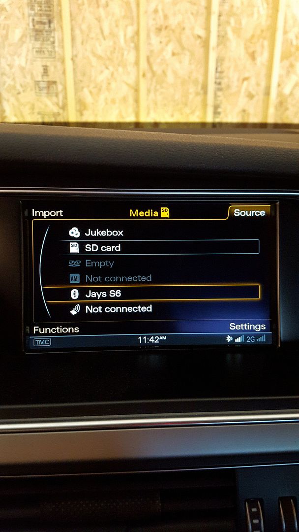

    On the MMI controls, click media, then in the media menu select source(top right silver button). You should see BT as an option.
    Make sure your phone is set to calls and audio via BT, as well as your streaming app. Hope this helps.

    You might have Bluetooth audio player turned Off in Settings. I've done this before when I got sick of my iPhone autoplaying music.
    Update: Look under Telephone > Settings > Bluetooth in your S4
