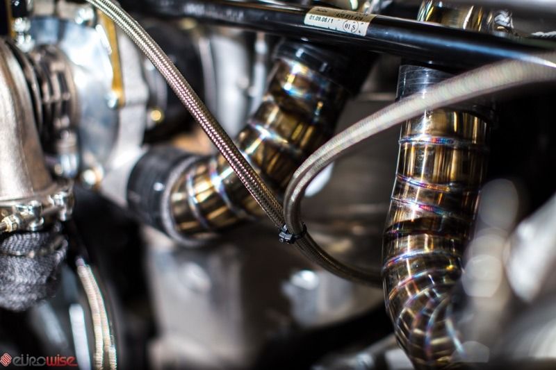

    I just about lost it when I saw the custom made IC pipes. Talking about no expenses spared!

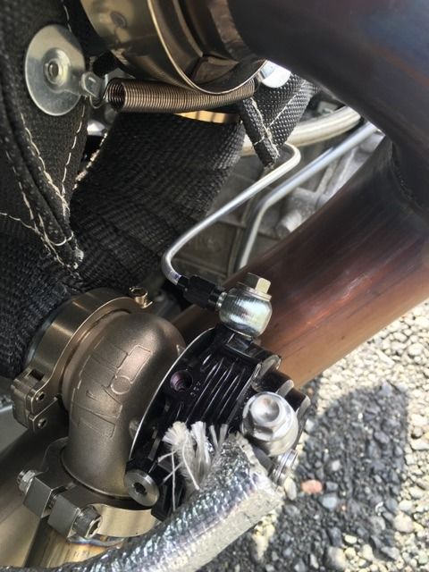

    One of my latest mods...

    Love this! Not sure if you remember but we met a few years back at one of the UNCC meets when I had my S4 and you had your A5 there. Was cool following along with the build via Mikes SC's and Eurowise posts on FB, glad to see everything came together so nicely. Enjoy her man, she's a beaut.
    Yes, I definitely remember. What are you driving these days?
