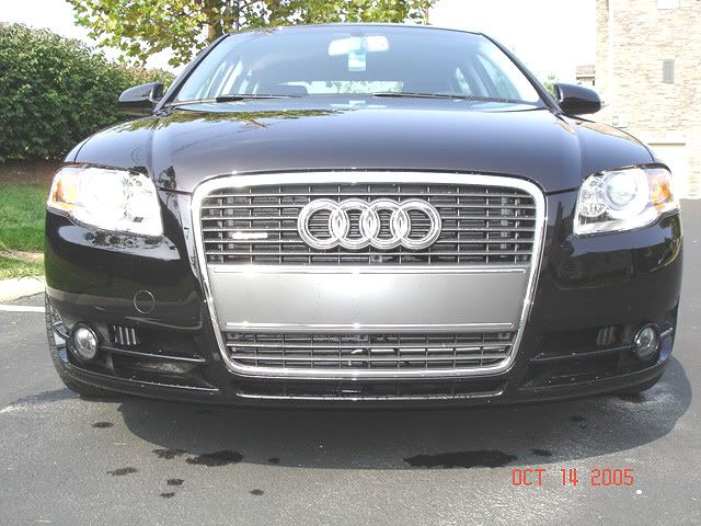

    Here are some before and after pics...
    BEFORE HEAD ON...
    AFTER HEAD ON...

    The ride height stock was...
    Front: 27 3/4"
    Rear: 27 5/8"
    The current ride heigh is...
    Front: 25 1/2"
    Rear: 25 1/2"
