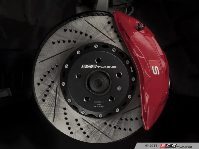

    I believe Ecs makes a kit of everything for the swap and they have a printable template to see if it fits your wheels
