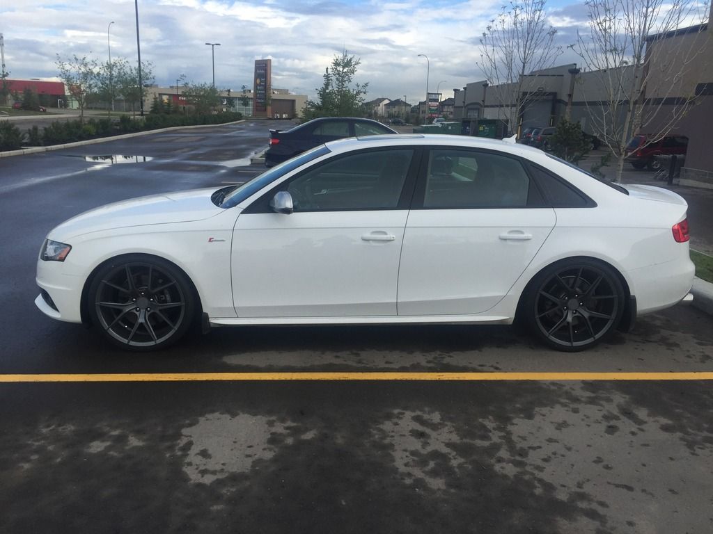

    Senior Member Two Rings Ek9max's Avatar
    Feb 14 2015
    315259
    Calgary/Alberta/Canada
    Better shot of the gaps. Looks perfect to me.
