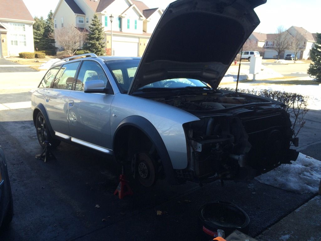

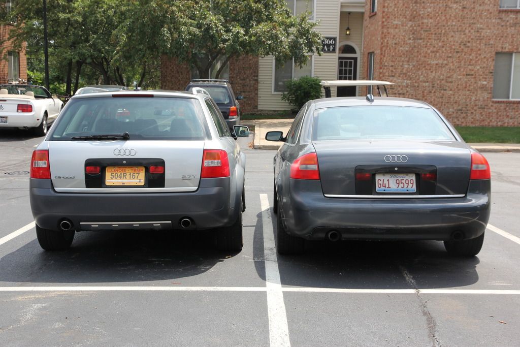

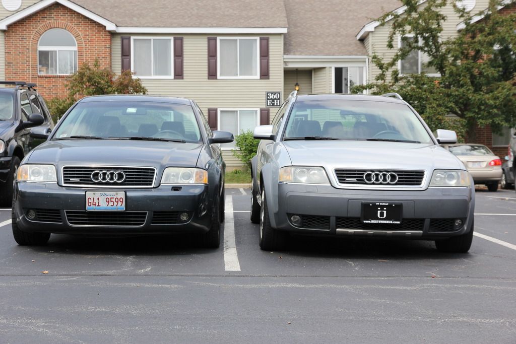

    On to the pictures! Here it is when I got it home, next to my A6.
    The snow hadn't completely melted yet but I was eager to get going!
    The coolant in it was pretty nasty looking...

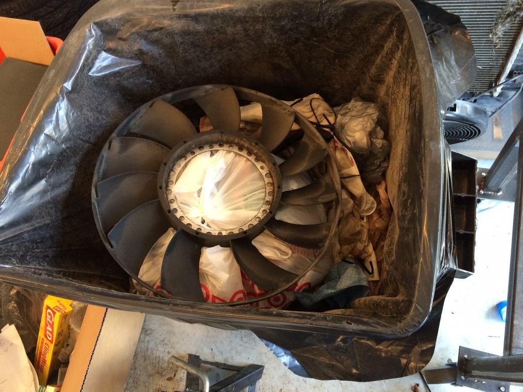

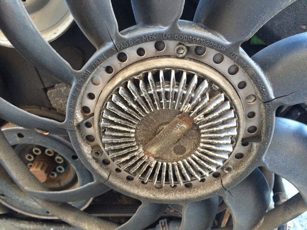

    The fan looked like a ticking time bomb so I gave it a new home.

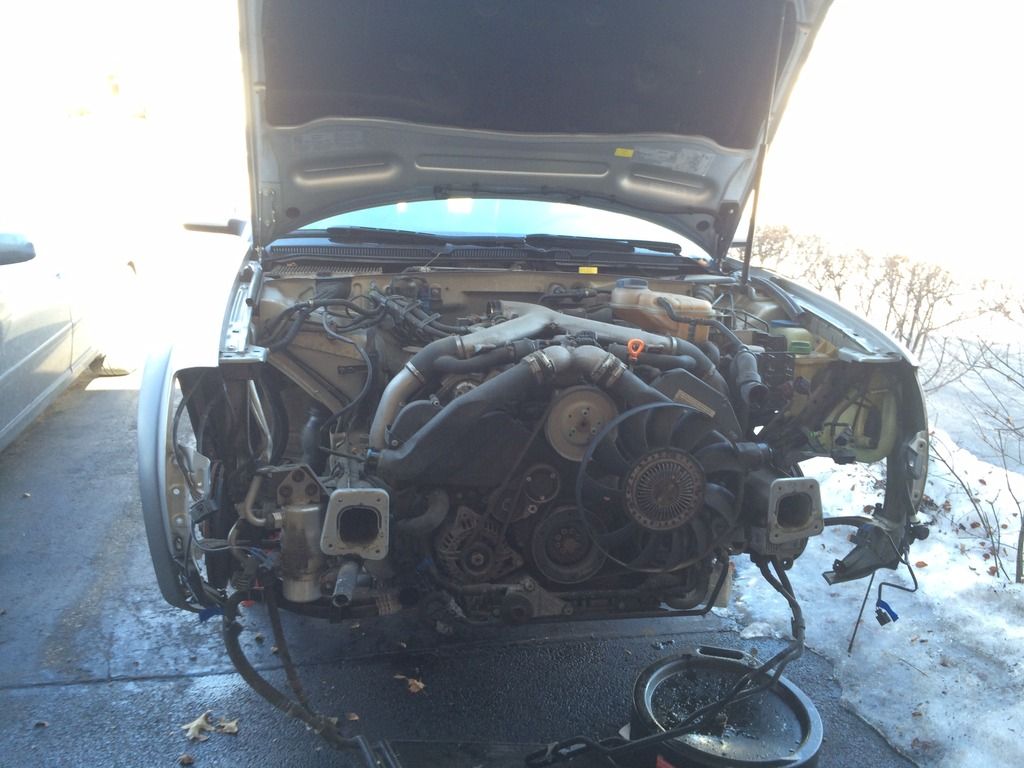

    Old engine coming out!
    Next step is for me to take apart the A6, hopefully I'll have time to get to that in the next couple weeks. After that I'll be making a couple little changes and here's what will be going back into the Allroad!

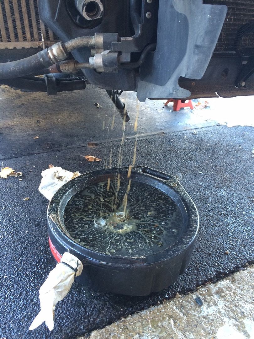

    Well it looks like I may be changing directions slightly with my build here. On the way to work Friday morning in my A6 I went to pass a semi and left a huge thick white smoke cloud behind me. Its made a little poof of smoke the last couple times Ive turned it on since, no smoke while idling or driving normally. I did a few part throttle pulls and as soon as I got around 15 psi a ton of thick oily-smelling smoke started coming out of the exhaust and it kept smoking for 15 seconds or so after I let off.
    I checked my catch can to make sure it wasn't full or clogged causing excess crankcase/valve cover pressure and it was all good so I'm afraid I might've blown a turbo seal. I'm gonna do a bit more research this afternoon on how I can confirm that is or isn't the problem... but it may be STK time
    Any suggestions about what else I can check would be appreciated!

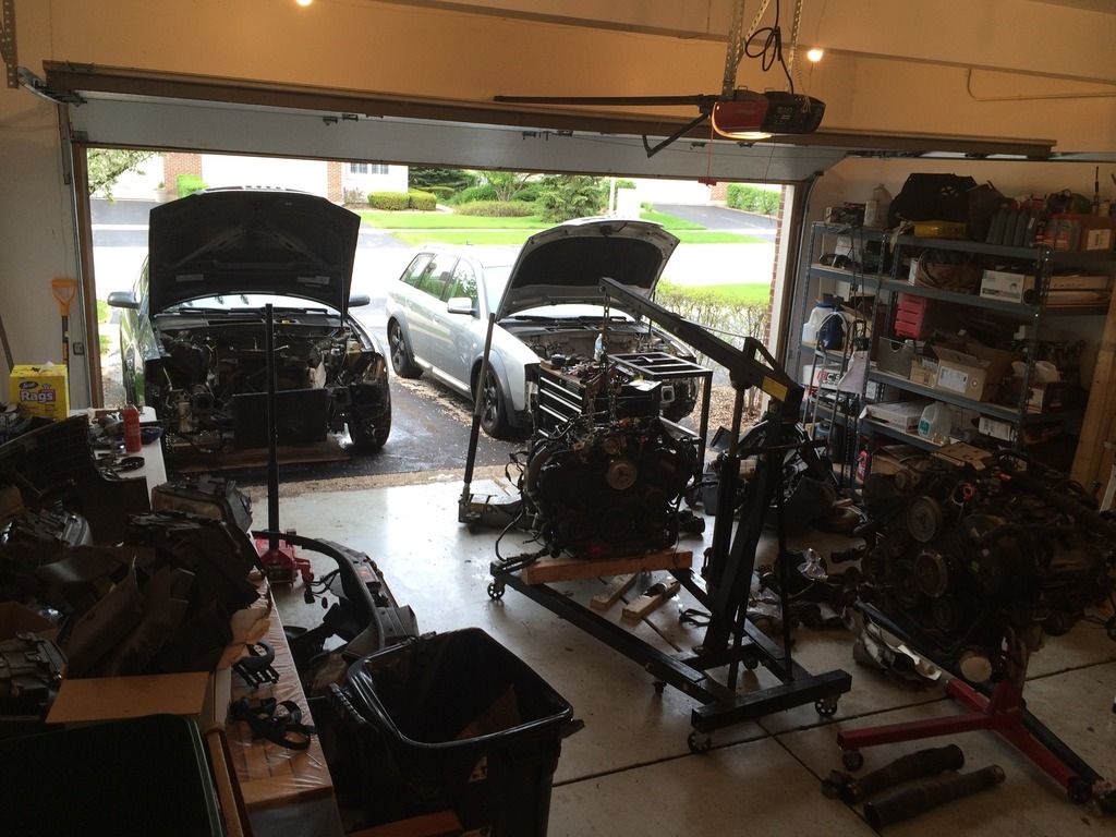

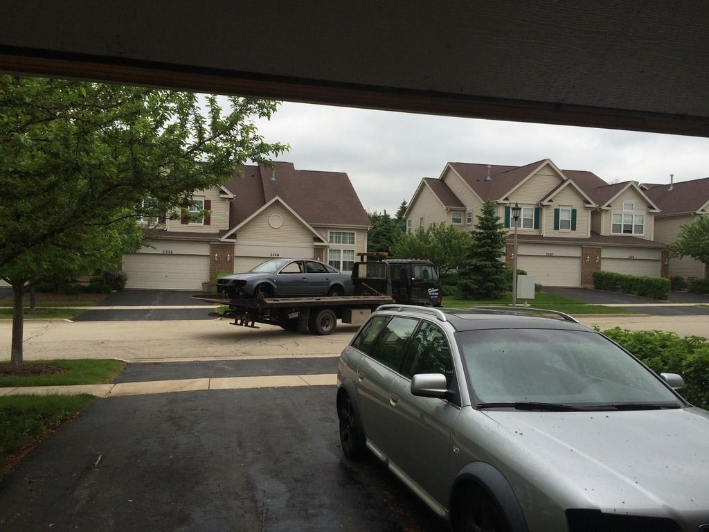

    Well, after spending some time yesterday afternoon poking around my A6, I'm pretty confident my driver's side turbo has a blown seal. I got more than 1/2 a quart of oil out of my lower drivers IC hose when I removed it, compared to maybe 4 drops out of the passenger side hose. I also did a compression test to be sure the motor was still healthy and had 160-170 psi (cold) on all cylinders so all is well there.
    I've got all of the weekend after next free to pull the motor out of my A6 and get ready to part out whats left of it to fund whatever I end up doing with the allroad. The practical part of me wants to just drop in some new turbos and get it back together but I know I'll regret that the first time I have to do any maintenance so... I'm really leaning towards going single turbo here, I've been looking at a GTX3576R with one of garrett's new-ish twin scroll T3 housings.

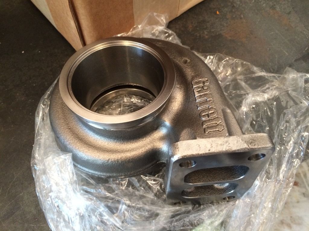

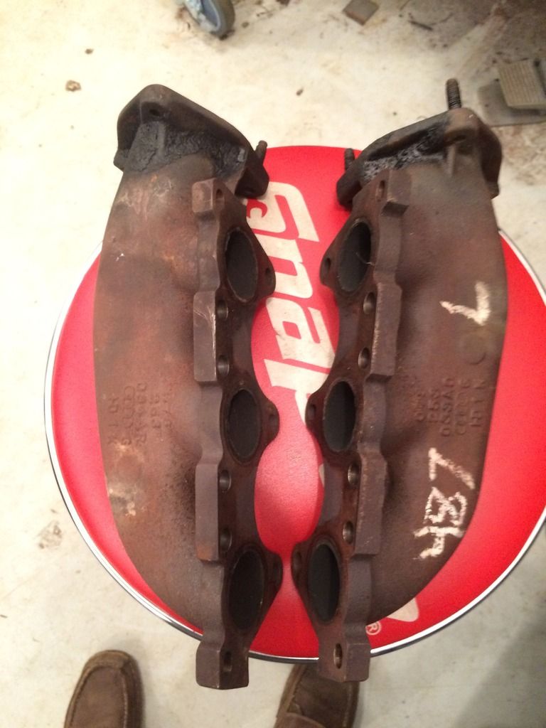

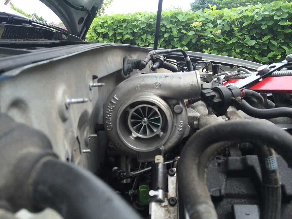

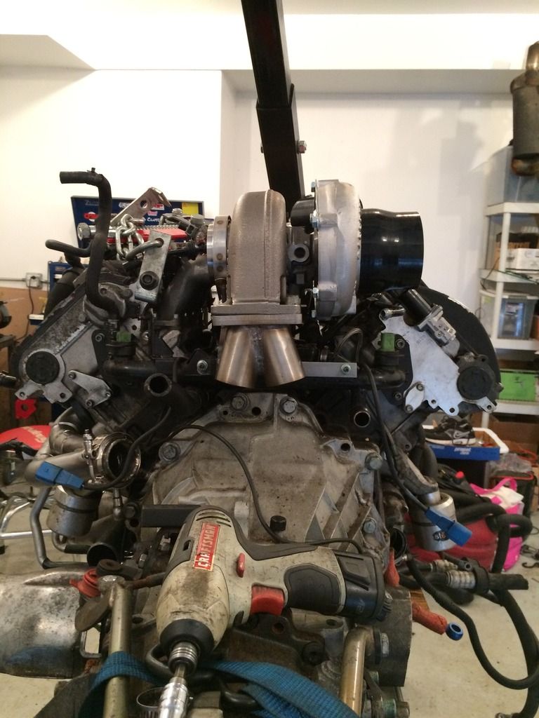

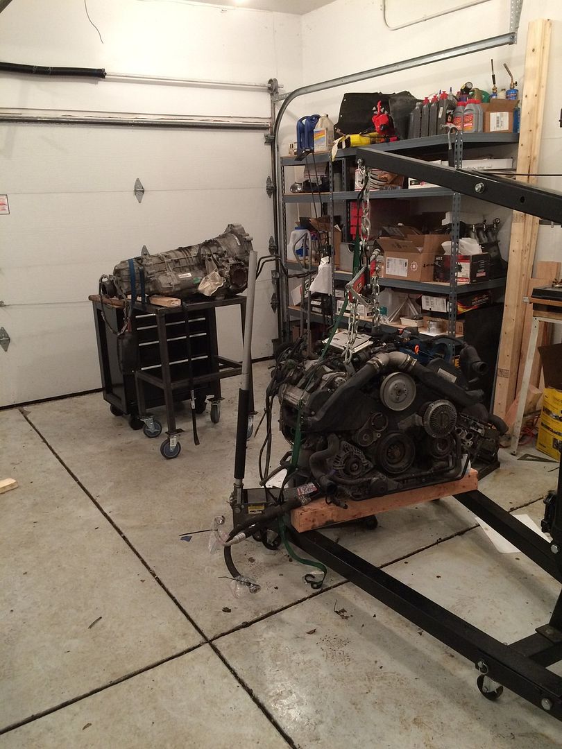

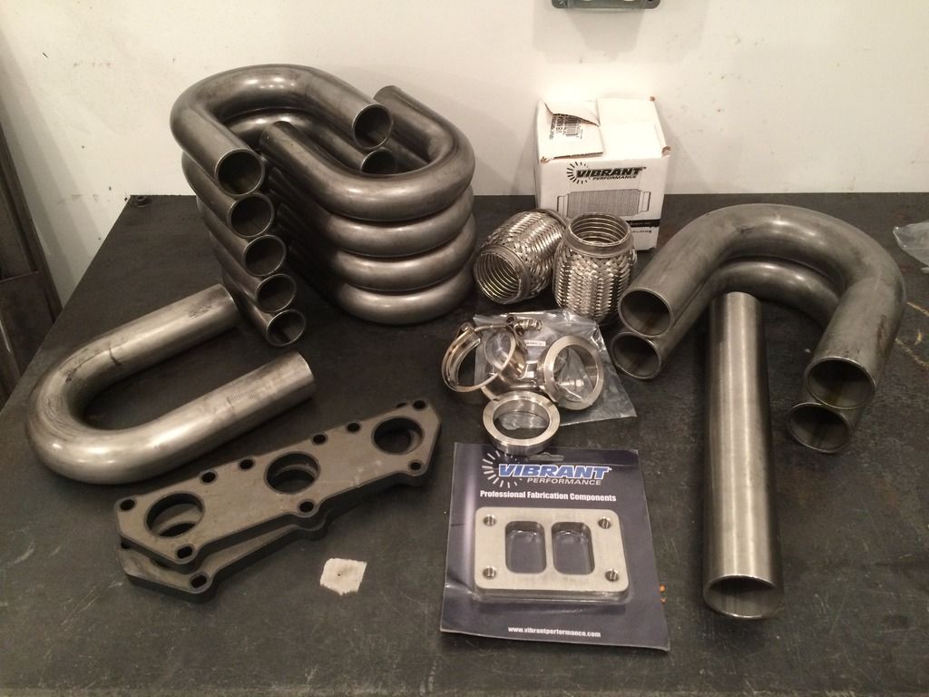

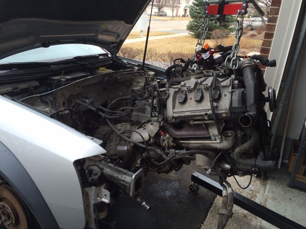

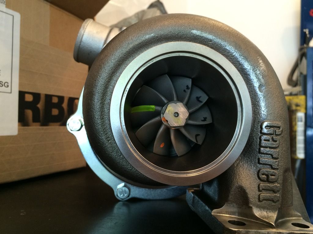

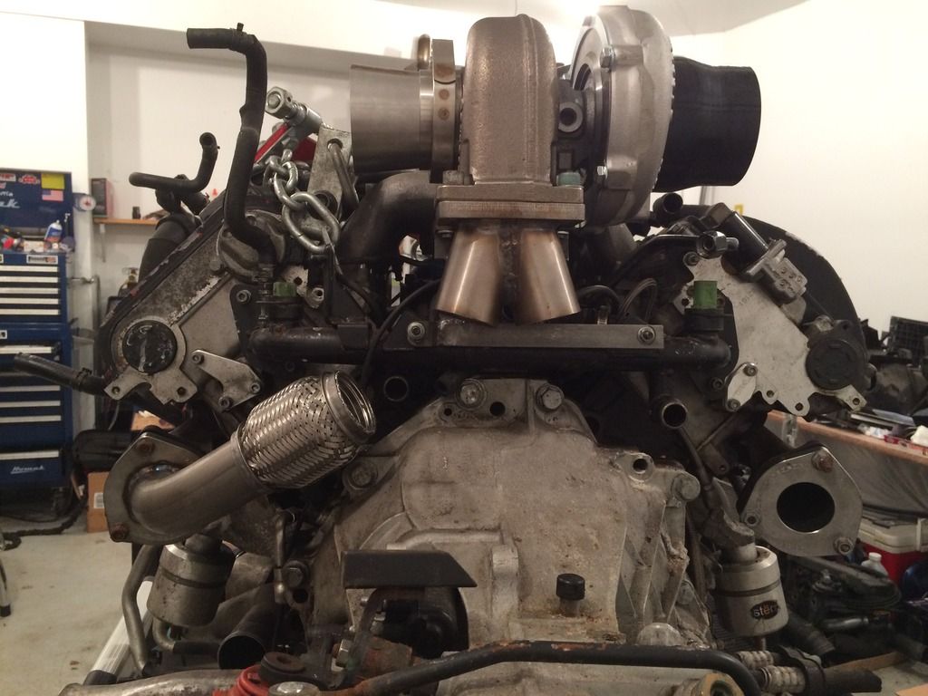

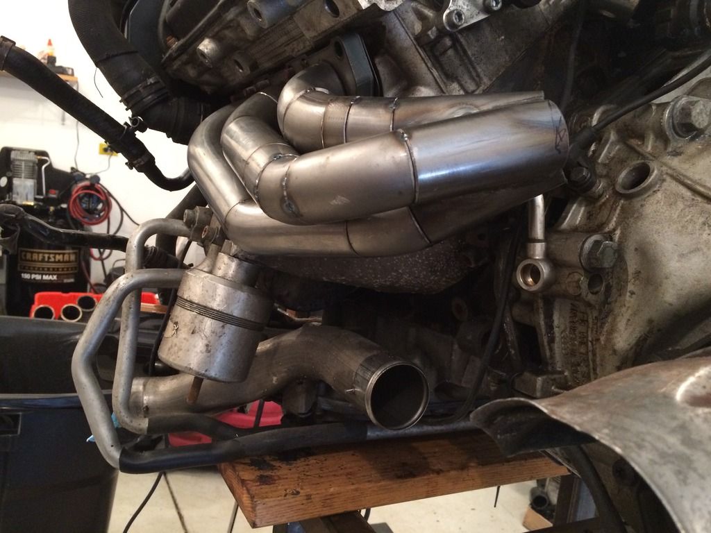

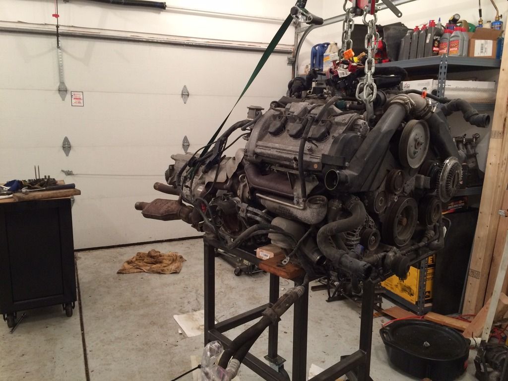

    Got the motor/trans out of the A6 today! Planning on getting the exhaust and the rest of the drivetrain out if I have time. If anyone is looking for any random parts from a 2004 A6 let me know! Im going to try to get everything worthwhile removed from it by the end of next weekend and scrap the shell.

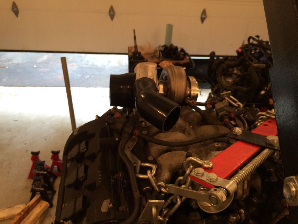

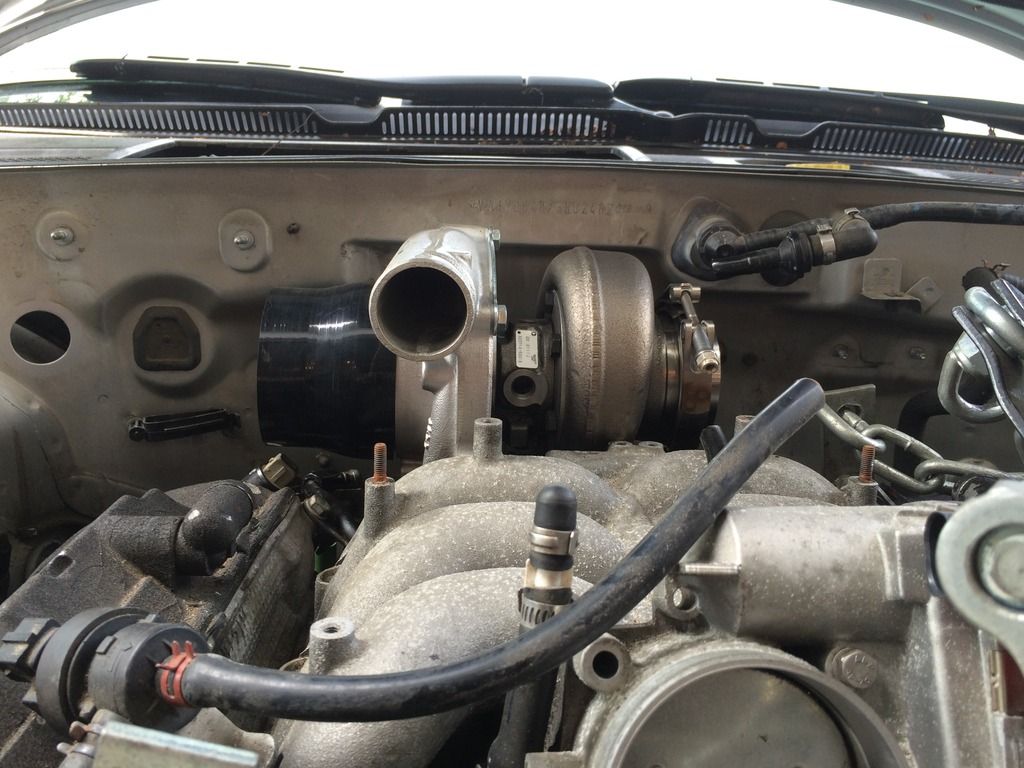

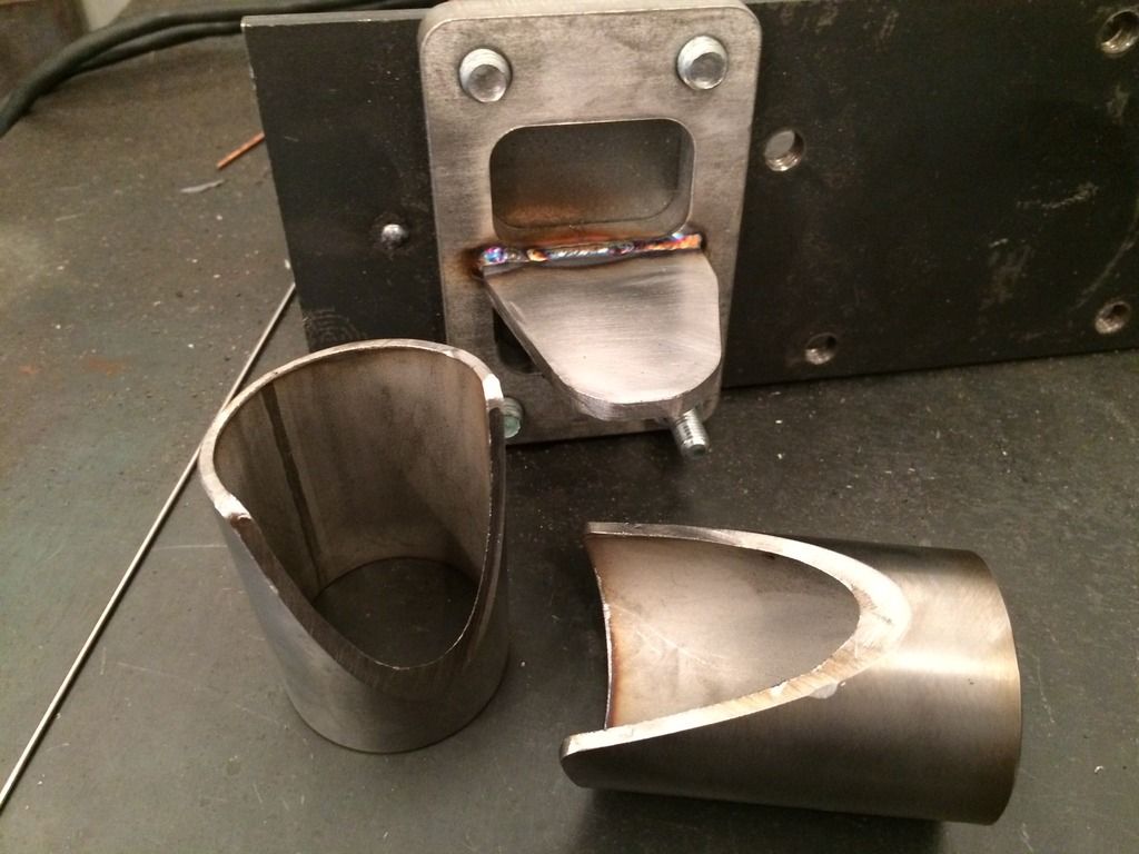

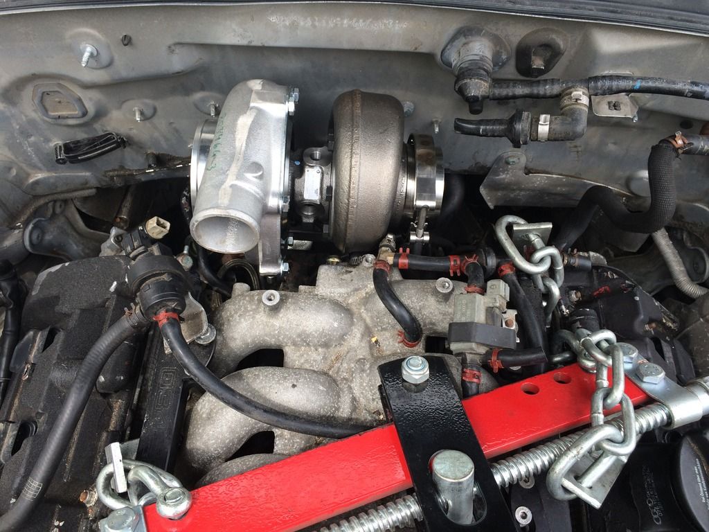

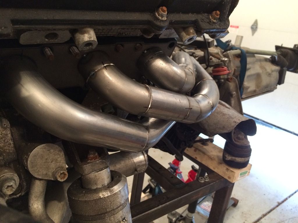

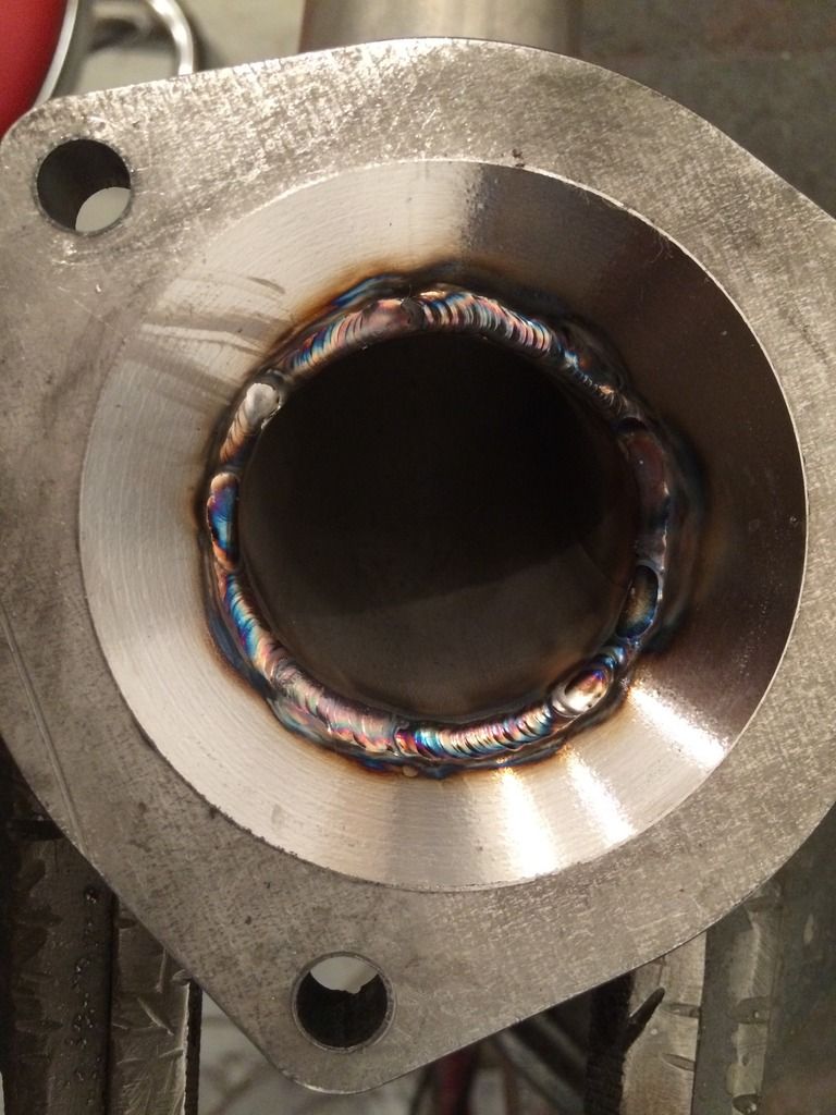

    I've decided to go ahead and go single turbo on the allroad! Gonna be a lot of work over the summer here but it'll be worth it. I'm going with the GTX3576R with probably a 0.83 Twinscroll T3 housing. Based on my research I should be able to hit 30 psi around the same point as my K24s did but it should get into boost a bit earlier, if I could have 15 psi by 3k that would be great which I think is doable as I've seen some logs from 2L evos having 10 psi by that point.

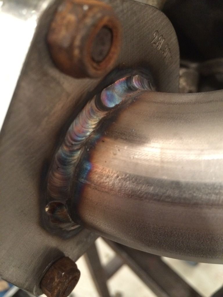

    I ordered materials to start working on the manifolds, 35mm ID primaries and 44.7mm ID up-pipes. Obviously I'll only be able to make the tubular lower part of the manifolds for now, the up-pipe will have to wait until I can order the turbo and have it in hand.

    Parts have been arriving yesterday and this morning!
    Manifold materials:
    Turbo and wastegates!
    Turbine housing

    Over the long weekend I finished pulling everything I wanted off the A6, and just got it taken away this morning. It was a bit sad seeing it go, when I first got it five years ago the extent of my mechanical abilities was limited to changing the oil or air filters… So it was an amazing, albeit frustrating at times, learning experience. At least its motor will live on in the allroad!
    During the evenings this week I’m going to get my garage and tools re-organized and am planning to start making the manifolds this weekend!
    Quote Originally Posted by Brandon002 View Post
    Thanks for the cluster and loaner tools man.
    It was nice browsing your 2.7 salvage yard / garage. Looks like you have almost enough in there to build a couple cars.
    Yeah, it’s getting a bit ridiculous… It’s even more full now from tearing down the rest of my old A6 than when you were over.

    It’s about time for an update here, I’ve made some good progress the last two weekends, and found another problem unfortunately.
    Bad news first - It looks like the valve guides in my 2.8 heads are leaking in 4 of the 6 cylinders to varying degrees… I’m probably going to swap back in my 2.7 heads and move the 2.8 cams over to those. Which means I’ll also unfortunately have to switch back to my stock intake manifold (RS4 currently). Sometime next year I’ll have to pull my motor to replace the clutch, so I guess I’ll aim to get the 2.8 heads rebuilt by then along with new springs.
    Onto the good news - I’ve got the drivers side manifold tacked together and the twin scroll collector/flange welded up and in place with a support bracket. If I get a good evening this week I’m going to put the motor back in quickly to make sure the turbo fits where I’ve got it right now before finishing up the manifolds. I’ve got it as close to the intake manifold as I can go, and the top of it is the same height as the Y-pipe so hopefully I don’t run into any problems.
    Primaries/merge collector, no v-band flange yet in these pictures
    Twin scroll collector parts
    Turbo placement

    I worked on the car a bit on Saturday, dropped the engine back in to be sure the turbo would fit where I’ve got sitting right now. And it fit with plenty of space to spare!
    I’m going to adjust the position a bit, moving it up about 1” and towards the drivers side 1/2”. That should help the intake clear the cct connector a bit better. It clears as it is now but one of the clamps would be rubbing on the connector which could cause some issues down the road.

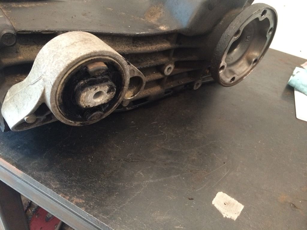

    I also window welded my rear diff mount, replaced the rear diff axle seals, refilled it with fresh fluid (Motul 75w90 + MoS2 additive), and reinstalled it under the car. I figured I’d give the window weld a shot before shelling out the $$ for the apikol mount. I went a little easier with the window weld than I’ve seen other people do, hopefully that’ll help prevent excessive NVH others have complained about.

    It’s about time for an update here! I recently went on vacation so I haven’t accomplished too much recently. After the vacation I got home feeling very recharged and ready to get to work, started welding my manifolds and then realized I had never check to make sure I could get the tig torch everywhere… and of course I couldn’t. I decided to go the 2.8l manifold route in the interest of time. Maybe I’ll go back and make some tubular manifolds down the road.
    I adjusted the turbo’s position slightly to give myself a little more clearance between it and the CCT connector. Here’s where it sits now. It’s barely touching the intake manifold right now, but I’ll be cutting and boxing off the back of the manifold to get rid of the hose barbs and give myself more clearance.
    Picked up 2.8 manifolds off eBay & the 034 flanges.
    Not much to see yet but here’s the start of the drivers side up-pipe.
    11ga stainless pipe was welded to the 034 flange inside and out to make sure I don’t run into any cracking issues down the road.
    I should have another update with a lot more progress to show after this weekend!

    Veteran Member Four Rings SteelyS6's Avatar
    Oct 29 2011
    83182
    Winnipeg Manitoba
    Beautiful welding, next on my to do list is learn how to tig weld! Hope you come to camp allroad with this!
    Veteran Member Four Rings ChicagosPhantom's Avatar
    Aug 28 2013
    121950
    02 Nemo S6 (stolen) / 03 Silver A6 2.7T K04 01E / 03 Daytona RS6 / 04 Dolphin A6 2.7T 01E / 02 Silve
    Chicago IL
    ^^^^Exactly what I was about to say after looking at those welds!
    Top notch!
    Could use you to re-weld my DP/piggies and flex joints...😉
