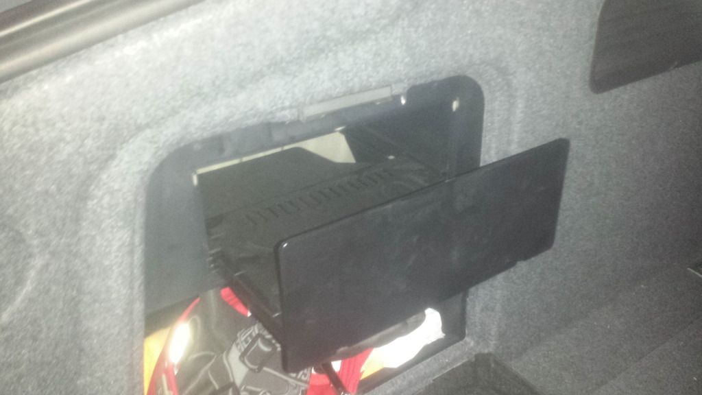

    For the install, DO NOT pull out the entire liner. Just drop the panel on the left side of your trunk down like in this pic:
    You see that rectangular shaped panel? Stick something in one of the little notches and pry it open. Its a drawer that slides out. If you have a satellite box it will be screwed onto it. If you don't have a satellite box, just pull the drawer out and stick your hands in the opening and feel around towards the top right for a harness wrapped in foam.

    THere is coding required IF your car didn't come with a satellite box. Yours did, so no coding is necessary. The OP will need to enable the SAT radio input on the stereo which requires coding.

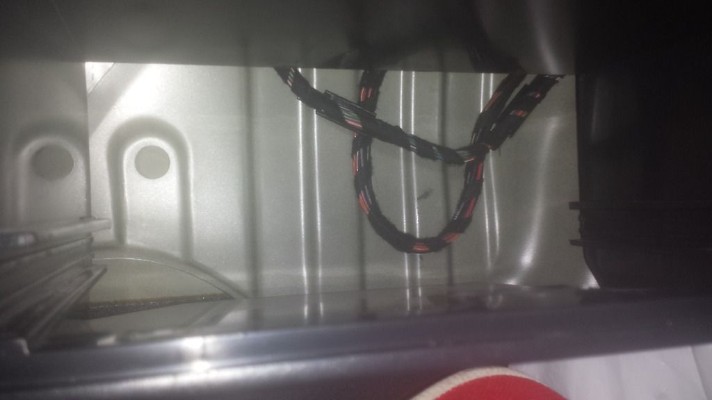

    Not missing anything, thats all you have to do. As I said, if you have VCDS its super easy.
    One thing I would do first, is double check that the Sat Radio harness is present in the car. I'm pretty sure they're prewired for it from 2003-up but its easy to check, and if you don't have the harness present you'll want to get a different adapter.

    I had a quick minute to check it out...
    The cover just slides directly out. It feels pretty sturdy too.
    Looking inside, you can see these two cable sets.
    Gave each a quick tug but their not loose. I'll need to pull off the full cover when I get home.

    Quote Originally Posted by VroomTT View Post
    I don't think those are the harnesses. It might be tied up lower down, the plugs will have a wrap of soft foam and be ziptied probably. The reason I suggested pulling the trim panel off was so that you're not groping around in there tugging on random wires until you break something. It seriously only takes a few more minutes.

    Finally got home and took another look. I reached in and up, and right away felt the foam. Wasn't zip tied at all, just curved up and resting on top of the unit.
    Popped off the foam and 4 clean connections to play with
    Also, as you can see from the pic, it was one of the wire sets I tugged on previously. I just wasn't comfortable with more than a light tug at the cables in a parking lot
    If only I had a picture of the connections on the mediabridge to compare...

    Right where I said it would be
    The module I linked you to connects to those satellite cables. Its your best bet for utilizing the SAT button on your radio.
    The media bridge that you are looking at appears to connect to the back of the radio and probably uses the CD button: http://audiovox.diceelectronics.com/..._rev062012.pdf
