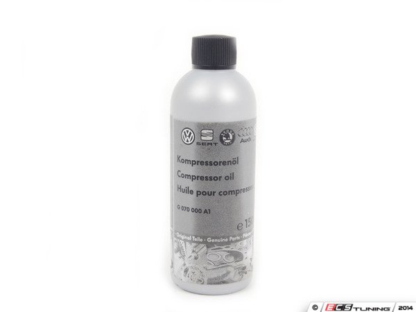

    Just curious if anybody on here has completed an oil change on their supercharger as of yet? I have to admit, I don't own an S4, I have an A6 3.0t, however the population of 3.0T owners is a bit higher in this area :) .
    I am pulling the Supercharger to install an APR Pulley, and to do an intake clean. While the charger is off, I figured it would make sense to service the Supercharger while it is off. I have read some threads that Mercedes owners would warm their SC in front of a space heater, or even place it in their oven (lowest temp possible) to warm the oil slightly. I don't see why either is needed, however, was curious if anyone has done this, and if there were any tips and tricks?
    Should be straight forward, but just curious if anyone has run into any gotchas!

    Car has 106.000 on the clock and I already have the oil. (#G070000A1) . I tend to keep my cars for 10 years 200,000+ miles, so I try to be good with maintaining fluids on my machines.

    Mine has a black allen plug on the front of the charger, where the gears and spring isolator are located. On other OEM Eaton TVS series chargers, this is where you would pull oil out to replace it.
    Since this appears to be such a foreign topic over here, I have taken earlier advice and contacted Eaton. I Just want to cover my bases while the thing is out of the car. If it doesn't need to be changed, less work for me! The oil was free from someone who no longer has a 3.0T car.

    OEM Application: Audi A6/S4
    Rotor: TVS
    Type Size: R1320
    Oil Fill (ml): 155
    Oil Fill (fl oz): 5.2
    There is an allen type screw in front of the charger.
    Im sure VAG has OE Specific oil.
    Considered lifetime, I call BS.
    100k, or less if high load as in racing/towing.

    It's a sealed bottle of Audi dealer sourced oil for our superchargers. I did send the part number of it to Eaton to confirm it is okay to use.
    I hope to know by next week when my Pulley and belt arrive :) .

    From Eaton wedsite :
    Q: How often do I need to change the oil in my supercharger?
    A: The sealed oil reservoir in a supercharger is designed to last the life of the vehicle. Changing the oil is not recommended unless you suspect contamination, leakage, or other issues like bearing failure. Also, if your vehicle has an abnormally heavy duty cycle, such as racing or towing, you could consider changing the oil at regular intervals such as 20k, 30k, 50k, or 100k miles depending on usage.
    Q: I’ve decided I need to change the oil in my supercharger. How do I do this?
    A: If you do want to change the oil there is one fill/drain plug on the front face of the front cover. It will probably be an Allen type plug. You will have to suction out the oil using a syringe or other method before replacing with new oil. Fill levels are dependent on application. For aftermarket units, please consult the aftermarket partner company that produced that specific kit. For OEM units, please see the list below or email infosupercharger@eaton.com. New oil can be obtained from any GM or Ford service parts facility, or from one of the Eaton aftermarket supercharger partner companies or remanufacturers. Please make sure you do NOT use any other type of oil, including synthetic motor oils. These will cause failure.
    OEM Application Rotor Type Size Oil Fill (ml) Oil Fill (fl oz)
    Audi A6/S4 TVS R1320 155 5.2
    Q: What about the bearings in the back of the housing? Do I need to grease these?
    A: The needle bearings in the housing of an Eaton supercharger are designed to last the life of the vehicle. If you have your unit repaired by an authorized Eaton supercharger remanufacturers, they will be able to replace or grease these needle bearings for you.

    Well I took the plunge and changed the oil last night. Since my charger was off, we simply poured out what we could, and replaced with the same volume of oil. The only real gotcha was the fact of the plug being in English units, as opposed to Metric. I had to raid the neighboring shop for a correct allen key, from which the plug easily came off. There is a small rubber O-Ring that I also replaced, otherwise it was a simple fluid swap.
    For comparison, 100k miles, versus fresh oil.

    We have the recommended supercharger oil from Audi available below. It's recommended be changed every 100K.
    Other possible conditions that could require more frequent changes would be racing or driving that constantly is working the blower and or sustained higher pressure/RPM such as a greatly reduced pulley size.
