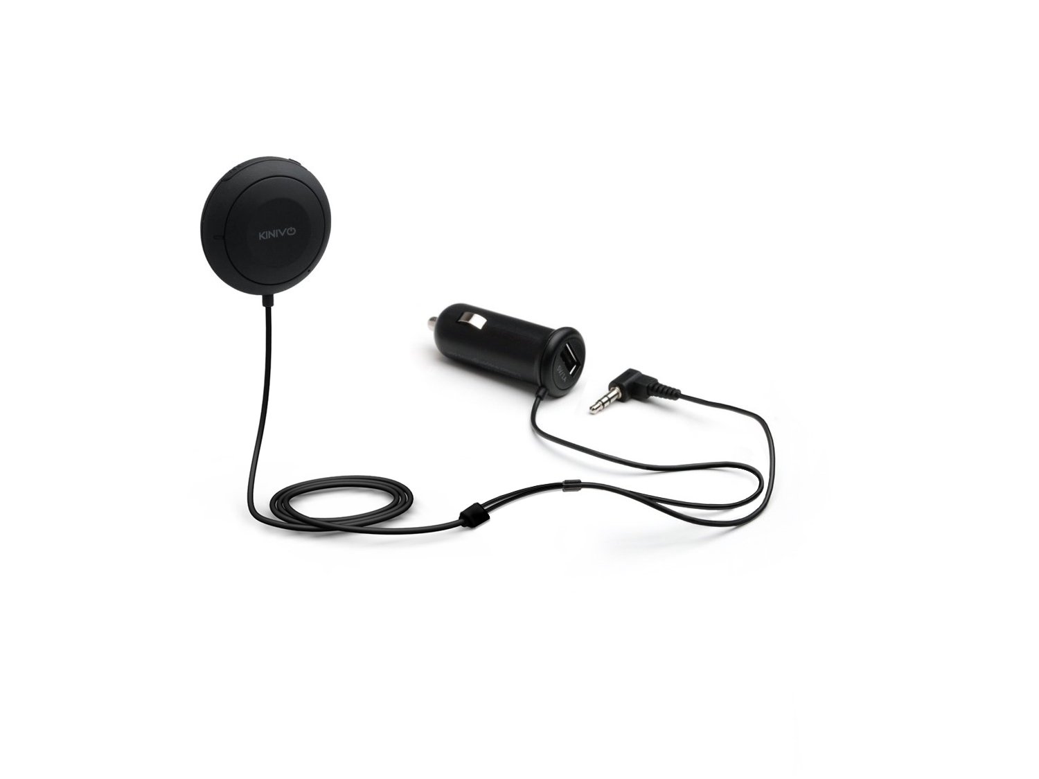

    Kinivo BTC450 Bluetooth Hands-Free Car Kit for Cars with Aux Input Jack (3.5 mm) - supports aptX $40 (found mine used for $33)
    http://www.amazon.com/gp/product/B00...?ie=UTF8&psc=1

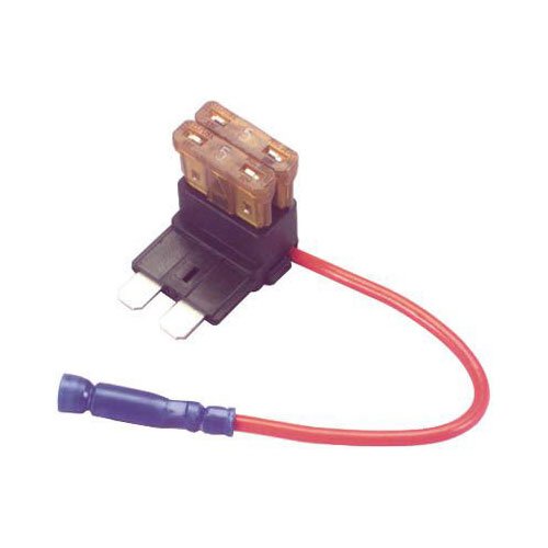

    Littelfuse FHA200BP ATO Add-A-Circuit Kit $5.42
    http://www.amazon.com/gp/product/B00...A1PH6OFMJYJKNX

    2. Then the 3.5mm M of the BTC450 plugs into the 3.5mm F/F adapter.

    6. Solder/crimp power wire on cigarette adapter to the add a circuit fuse kit.
    7. Install the "add-a-circuit" with 3A fuse to the passenger side fuse box.

    the himbox is something i looked into as well. i found a good used btc450 so i went with that. benefit of btc450 is that it's not all glowy and more feedback on the internet.
    when i originally thought my setup up, i was going to put the device in the glove box. instead i ended up mounting it under my driver side heating button. there's a nice benefit to just hitting the 'next' button if you dont want to bother pulling your phone out. another change was that i bought a road pro adapter where i just cut the clamps off and had a nice ground and power wire to use.
    i can take a pic of how it looks inside sometime. the sound quality is really great. only a hair below wired quality. much better than typical bluetooth audio though. it starts up and autoconnects to whatever media player i choose (using an android app). i wonder if there's a way to voice control pandora, spotify, or other media players like "google skip song" or something like that.
